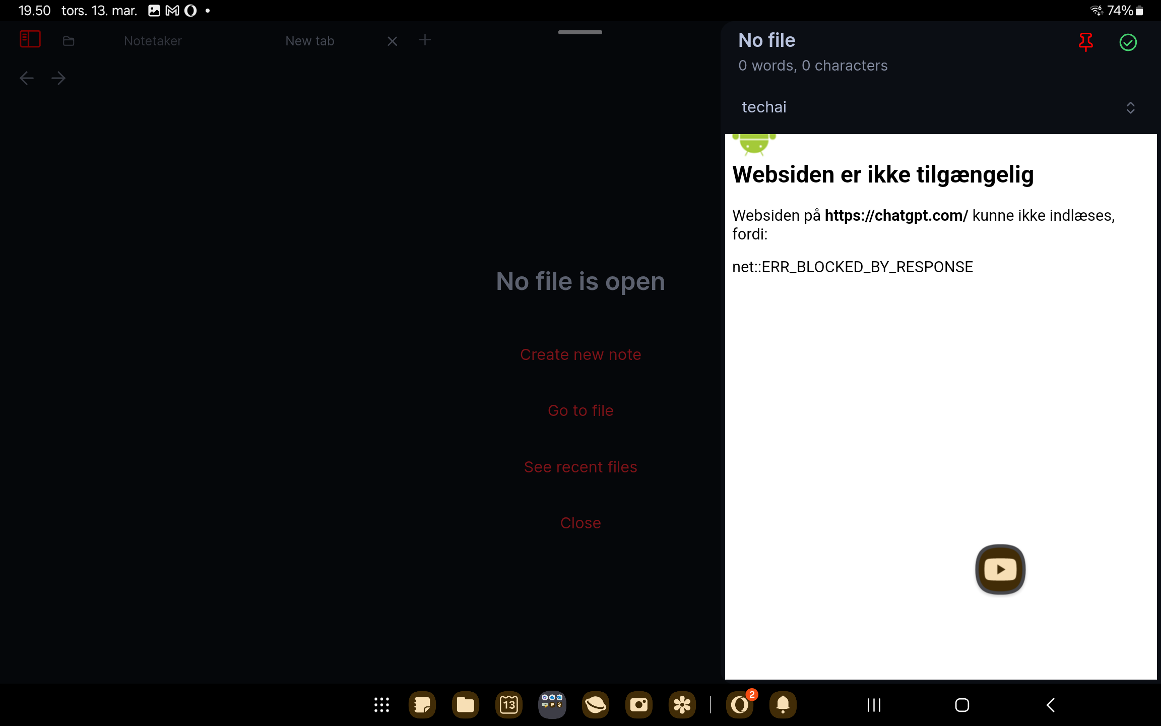

net::ERR_BLOCKED_BY_RESPONSE in Obsidian.
Hi hope somone can help me with this. I use the plugin called custom frame for implenting Google and ChatGPT/OpenAi.
Somehow whatever plugin i use for network acces i get blocked. I also checked my tablets premission setting, and can only change settings for microphone but not network and file management.
someone knows how to get around this?

I understand.
So if i´m right, I need to accept and understand, it can´t work in obsidian mobile/tablet unless i go to a desktop. The disable function work so the plugin gets activaded. Thats it. Then i need to use the browser instead.
Had the idea tha i could use plugins like copilot with acces for the web, but that didn´t work ether, because of Electron can´t run on Obsidian mobile.
Thanks for the feedback.
That’s how I understand it.
I’ve only ever used customs frames on desktop Obsidian, but as the readme says, complex sites/services requiring logins, etc., probably won’t work.
So, I guess we can confirm it now. :smiley:
I just tried with Google, DuckDuckGo, etc., and it’s not going to work. Maybe it could be used for a local web service or something similar—I don’t know.
I actually just wanted a copilot that could read my PDF files from school using the OpenAI assistant. But if the network is blocked, I can’t get anything to work on a tablet.
Those copilots only use my own Markdown files and can’t read PDFs or search the web. So, lesson learned: Never try to set up a tablet as your main workspace like a desktop—unless perhaps it’s Windows-based and run Electron for iframe usage.
