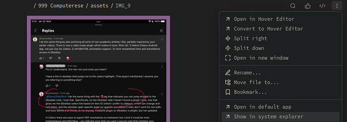

You can also click on the three dots in the upper right hand corner if you are on desktop:
  • Rename can be accessed from there.

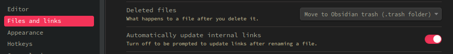

I would assume people would normally have this
turned on. I think Obsidian comes with this setting as default ON too.
