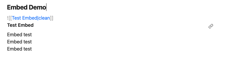

Embed on desktop:
Embed on mobile:

No cssclass and no alt:
cssclass: embed-clean and no alt:
That said, your snippet as is, using only the alt text |clean]] in the link, seems to be working for me on mobile:
