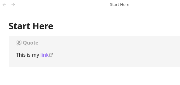

Yes. Sandbox vault screenshots on Linux attached
This is reading mode:
This is what I see in live preview mode:
Amusingly, when callout itself is in live edit mode, the link is rendered okay

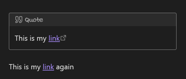

A workaround that might not ideal but gets the job done for now.
Reference-style links called inside a callout will render in Live Preview and Reading when you define them inside the callout:
> [!quote]
> This is my [link][ref]
> [ref]: http://example.com
This is my [link][ref] again
The definition requires a blank line before it. And the reference link is callable from both inside and outside the callout.
Live Preview (the hybrid view):
