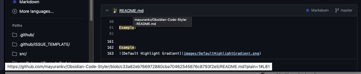

Having something similar to the search result from GitHub would be a very fancy variant, like the image below where I searched for “example” in the Obsidian Code Styler plugin:
Nice aspects of such a view includes:
- Having a proper link to the original document
- Using the title line to add buttons to update the code
- And one could use a link similar to that shown to specify which block to show… Possibly with the line number combinations as offered in the plugin.

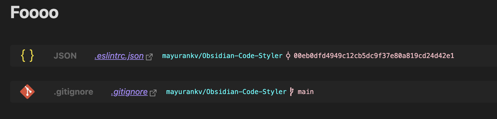

Currently I have it set to look like this with what will be customisable colours for repo and branch/commit:
(zsh prompt style kind of haha)
That info is automatically found via the link. The only additional things I want to add are a timestamp for when it was updated and an icon indicating GitHub vs gitlab vs bitbucket vs sourceforge etc.
