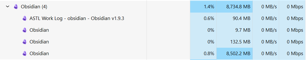

Well, I’m pretty sure the 4GB limit isn’t correct. Here’s my task manager.
This was from a few minutes ago.

The task manager snapshot is after i did this. I have 128GB of memory in my laptop. So, 8 GB isn’t a huge problem. 8.5 GB does seem like a lot.

That looks like the OS level (Windows?) task manager reporting 8GB for the whole process.
That means it reports total process memory. The 4GB limit is the heap that’s accessible to user memory (aka JS object cage or V8 memory cage - Electron and the V8 Memory Cage | Electron) - i.e. what Obsidian can allocate.
Naturally, in order for user memory to be 4GB, the VM needs to allocate in addition to that to operate, so that’s why you’re seeing a difference.
