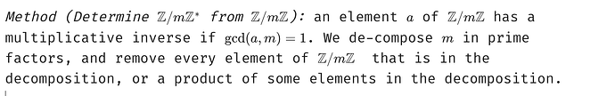

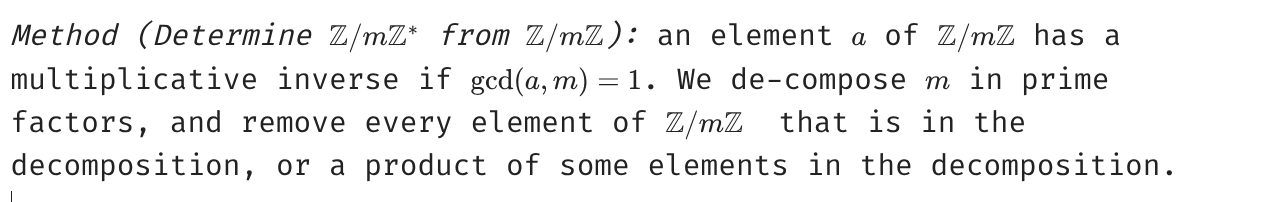

In editing mode: go to italics with * character. Then start an equation $. In the equation, use a * character. Close the equation, close the italics.
The text that made me discover it:

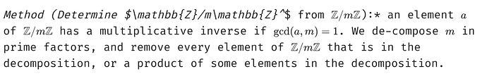

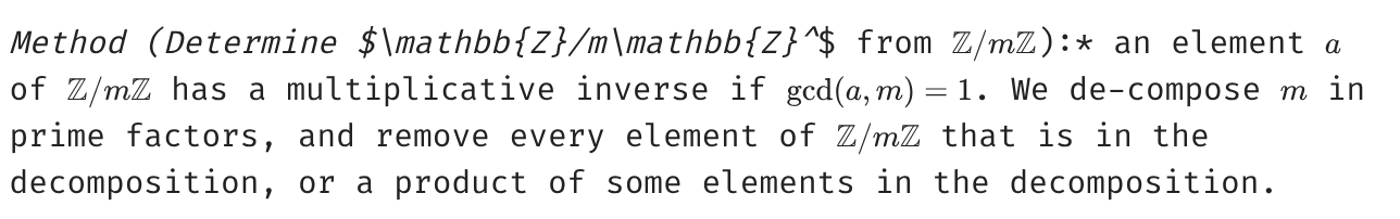

*Method (Determine $\mathbb{Z}/m\mathbb{Z}^*$ from $\mathbb{Z}/m\mathbb{Z}$):* an element $a$ of $\mathbb{Z}/m\mathbb{Z}$ has a multiplicative inverse if $\gcd(a, m) = 1$. We de-compose $m$ in prime factors, and remove every element of $\mathbb{Z}/m\mathbb{Z}$  that is in the decomposition, or a product of some elements in the decomposition.
Yes
When the markdown is interpreted, the * in the equation does not close italics outside the equation.
This is the interpretation expected (correct in editing mode):
In reading mode only (interpretation is correct in editing mode), the * inside the equation closes the italics outside the equation.
In this example, there is a * symbol between ^ and $.
My interpretation: the * symbol inside the equation is interpreted as markdown, and hidden. The text afterwards is not in italics anymore.
The first equation is not interpreted anymore, as when the * is hidden the math becomes illegal. That’s not a bug, only a consequence.
