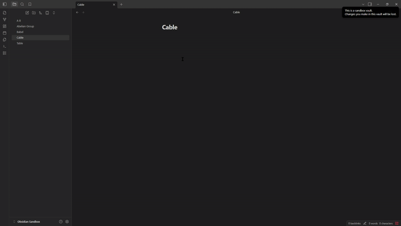

  • Open the sandbox vault and delete all files/folders.
  • Create the files A B and Cable.
  • Open the Quick Switcher (Ctrl + O) and search for A B.
Cable-ObsidianSandbox-Obsidianv1.9.112025-08-2417-19-58-ezgif.com-video-to-gif-converter
The file A B.md is the first recommendation.
The file Cable.md is the first recommendation.

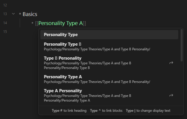

Here I have a practical case of the bug which could lead to future problems in my personal knowledge base.
  • Problem: I typed Personality Type A but the first recommendation is Personality Type. If I should have more Personality Type-Concepts then I’ll come into trouble as I won’t find Personality Type A anymore at all.
  • Bug Notes:
    • It seems that the bug happens especially if words of single letters (in this case A) are used.
    • I’ve tried to rename the folders Personality Type Theories and Type A and Type B Personality both to dfg but Personality Type is still prioritized before Personality Type A.
