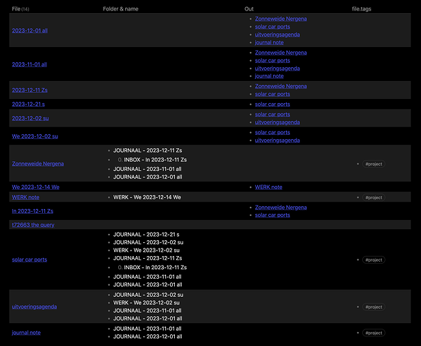

I finally got around to building some test folder structures, and ran a debug query to try to eliminate some of the kinks.
My test folder setup
I tried to replicate how I think your file setup is, so I made a WERK and 0. INBOX folder with some #project files linking a little here and there, and a JOURNAAL folder with some entries linking to the project files. I’ve also made sure that I’ve got a project file only linked from a journal, and one only linked from a notice folder as these present rand cases when filtering the links.
Regarding naming of the files, I’ve made all the inlink files contain a date, and the file name ends with a letter combination indicating where it links, so Zs means it links to the “Zonneweide Nergena” and “solar car parts” project. Some of the project files have a prefix indicating in which folder it originated, like We 2023... from within the “WERK” folder. These clues are not used in the filtering, only as visual clues when viewing the output table.
Here is a view of my test file setup:
The “Folder & name” column are only the inlinks to that file, showing the folder and the file name of the inlink.

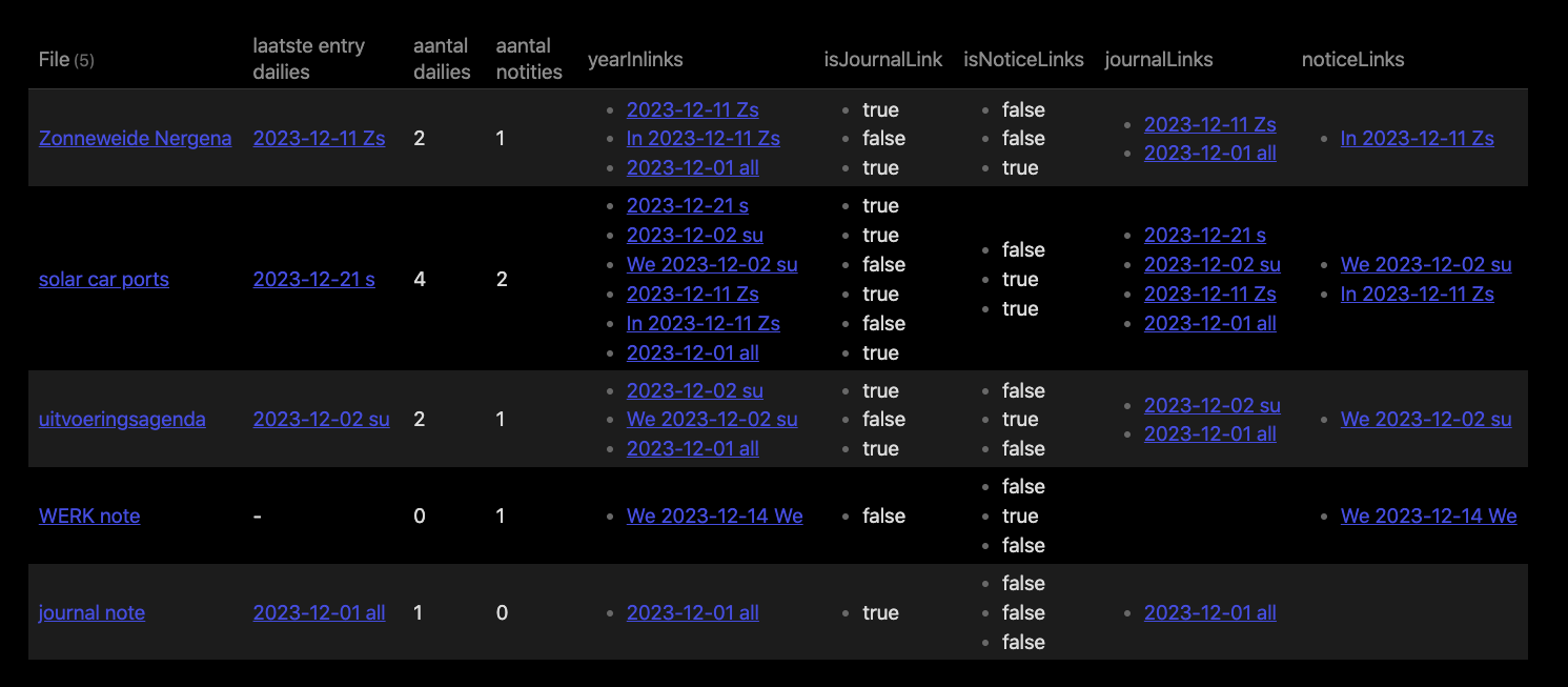

The query I ran:
```dataview
TABLE
journalLinks[0] AS "laatste entry dailies",
length(journalLinks) as "aantal dailies",
length(noticeLinks) AS "aantal notities"
, yearInlinks
, map(yearInlinks, (y) => contains(y.file.folder, "JOURNAAL") ) as isJournalLink
, map(list("ARCHIEF", "WERK", "0. INBOX"),
(m) => contains(yearInlinks.file.folder, m)
) as isNoticeLinks
, journalLinks
, noticeLinks
FROM ("WERK" or "0. INBOX" or "1. PROJECTS" or "ARCHIEF") and #project
FLATTEN list(filter(file.inlinks, (in) =>
in.file.day.month = 12 )) as yearInlinks
FLATTEN list(filter( yearInlinks, (y) =>
contains(y.file.folder, "JOURNAAL") )) as journalLinks
any(map( list("WERK", "0. INBOX", "1. PROJECTS", "4. AANTEKNINGEN"), (m) =>
contains(y.file.folder, m) )) )) as noticeLinks
WHERE yearInlinks
Limit 15
This query should resemble yours a lot, with the exception of all the additional columns I’ve added for debug purposes. NB! I do however use in.file.day.month = 12 instead of in.file.mday.year = 2023, so that I could build a better test for myself. You do need to change that part.
Which gave this output:
In the rather condensed table we can see that the journalLinks and the noticeLinks are populated with the correct inlink entries (and that the entry from last month is ignored). We also see in the is??? columns how each of the yearInlinks matches against that criteria. My test cases also includes elements where either the journalLinks or noticeLinks are empty (which could cause some issue with them ditching the entire row).
