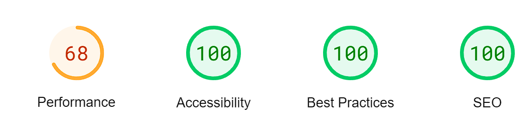

"Publish" performance Issues
The bigger my online vault gets, the more performance issues I am having. I have pages on mobile that take up to 30 seconds (!) to load on my phone.
Google’s Pagespeed test is confirming this.
https://pagespeed.web.dev/analysis/https-publish-obsidian-md-ryan/zugz1yea9l?form_factor=mobile
Luckily, they are telling us where it is happening.
/lib/prism.min.js
(publish.obsidian.md) 1,685 ms 1,558 ms 50 ms
/app.js?5d4aadd…
(publish.obsidian.md) 724 ms
Thank you.

Since it says “Core Web Vitals Assessment: Failed”, it feels like there is something wrong?
According to what I read, if a site takes 3 seconds to open on mobile, 53% of users will leave before it opens. We are at 2.9 seconds now, so…if it continues? For some reason, mobile is much slower.

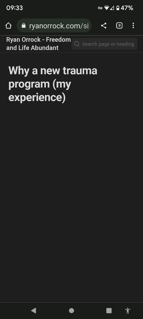

It seems to be sporadic. Perhaps it’s when I just upload new content? And it is “processed” for the first time?
Here are two screenshots of what I saw while waiting each time.
The main homepage said “Loading” for 9 seconds this morning after I updated my page.
The other page sat with just the heading for 20+ seconds yesterday.
After the initial load, the rest of the browsing seems OK, speed-wise.

Just tried again. First page: 14 seconds. Everything else: fast

Also, general performance is gradually degrading on the site, with every new 10ish pages, dropping .1 seconds (see screenshot).
At this rate, if I have 500 pages, it will be 5 seconds. 1000 pages, 10 seconds, etc.

Score went from 58 → 82 (as I’m sure you know…hmmm…it keeps climbing every time I test…now at 92). (and 100/100 on desktop!)
