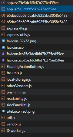

I’m at my wits end here; no matter what I’ve tried my publish.css files is being replaced by app.css when published.

frontmatter-style.css is working just fine within the app. No matter what I’ve done so far it seems that publish.css is completely ignored/overridden by app.css.
