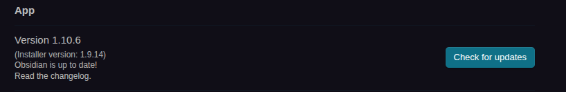

OBSIDIAN APP-Version:

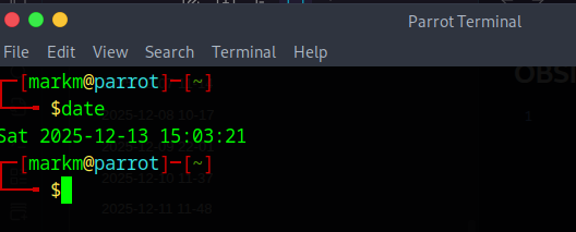

OS-DATE FORMAT:

Linux parrotOS
The YAML date format is fixed and doesn’t depend on how you configure your system
