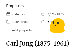

I have same problem date property format is mm/dd/yyyy while in language/region the format is correct (dd/mm/yyyy)
There’s definitely a bug involved.

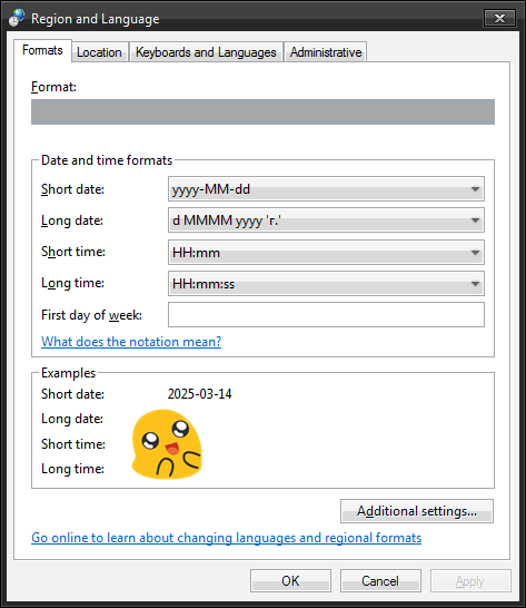

OS Windows 7 SP1 x64 + Obsidian 1.8.9 via VxKex.
OS uses YYYY-MM-DD, but Obsidian property insists on MM-DD-YYYY. Aggrrhh!

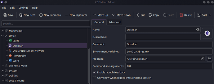

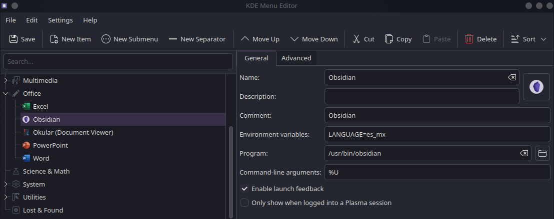

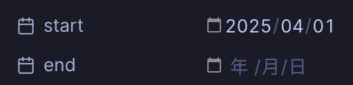

I also just tested changing the environment variable for the language on the launch options of obsidian in KDE, and fortunately that’s the only thing I needed to change for it to show correctly the date format.
Before:
After:
Just for the heads up I am using obsidian installed directly via the Arch Linux package manager instead of an AppImage so results may vary between installation method and/or distro so perhaps the other steps that you did may be necessary for the AppImage installation.

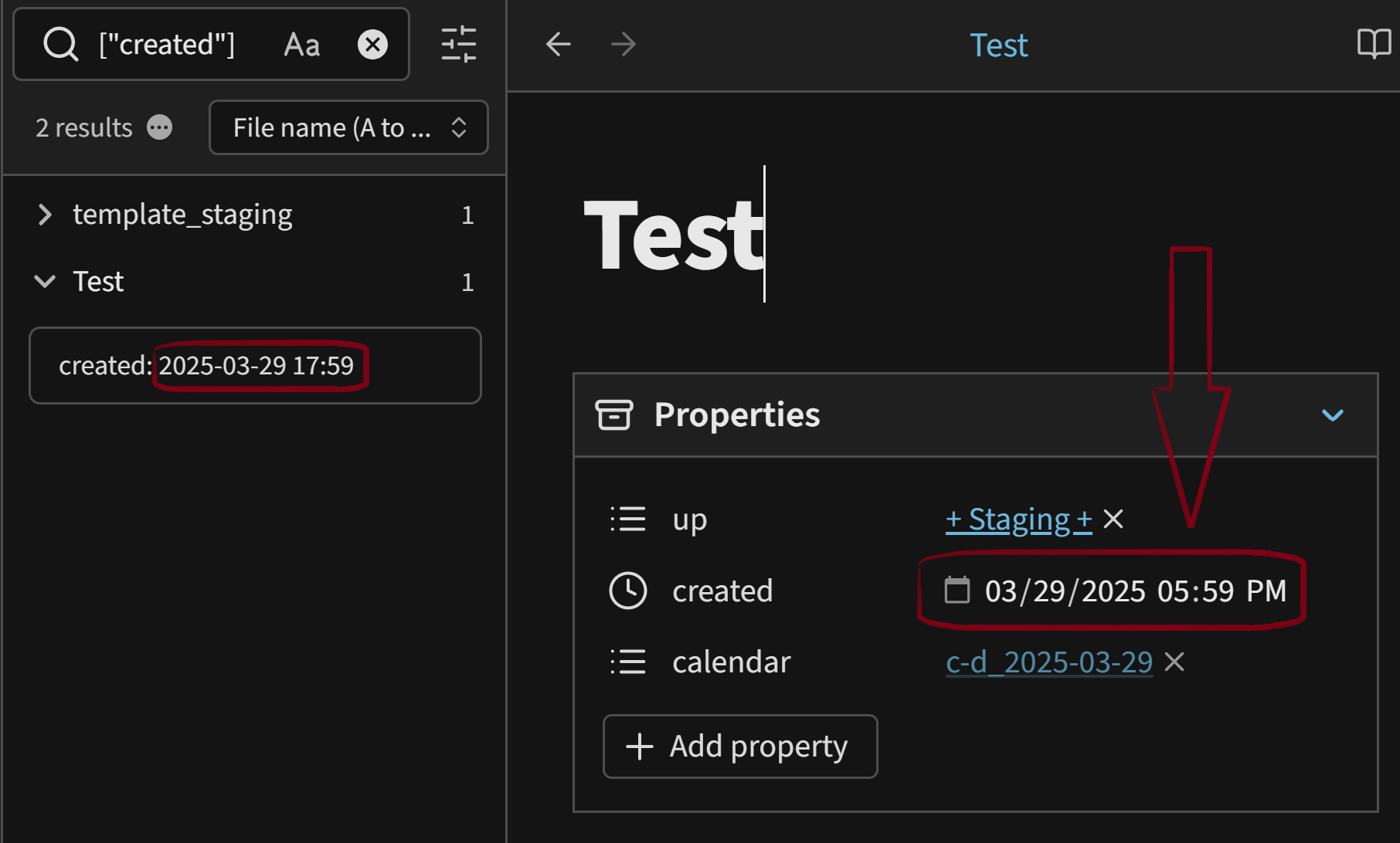

I’ve set a YAML property with the Property type “Date & time”. I fill it out as yyyy-MM-DD HH:mm. I want it to be displayed as 2025/03/29 17:59 , but instead it displays in American style 03/29/2025 05:59 PM. When I inspect the property, it has the correct yyyy-MM-DD HH:mm.
I’m on Windows 11 and my system is set to Japanese (which follows yyyy-MM-DD format), but my Obsidian display language is set to English. I also sync with an Android phone among others and don’t want to go a hacky way for all my devices.
I very much would like to change the displayed format. I hope this added to Obsidian soon.

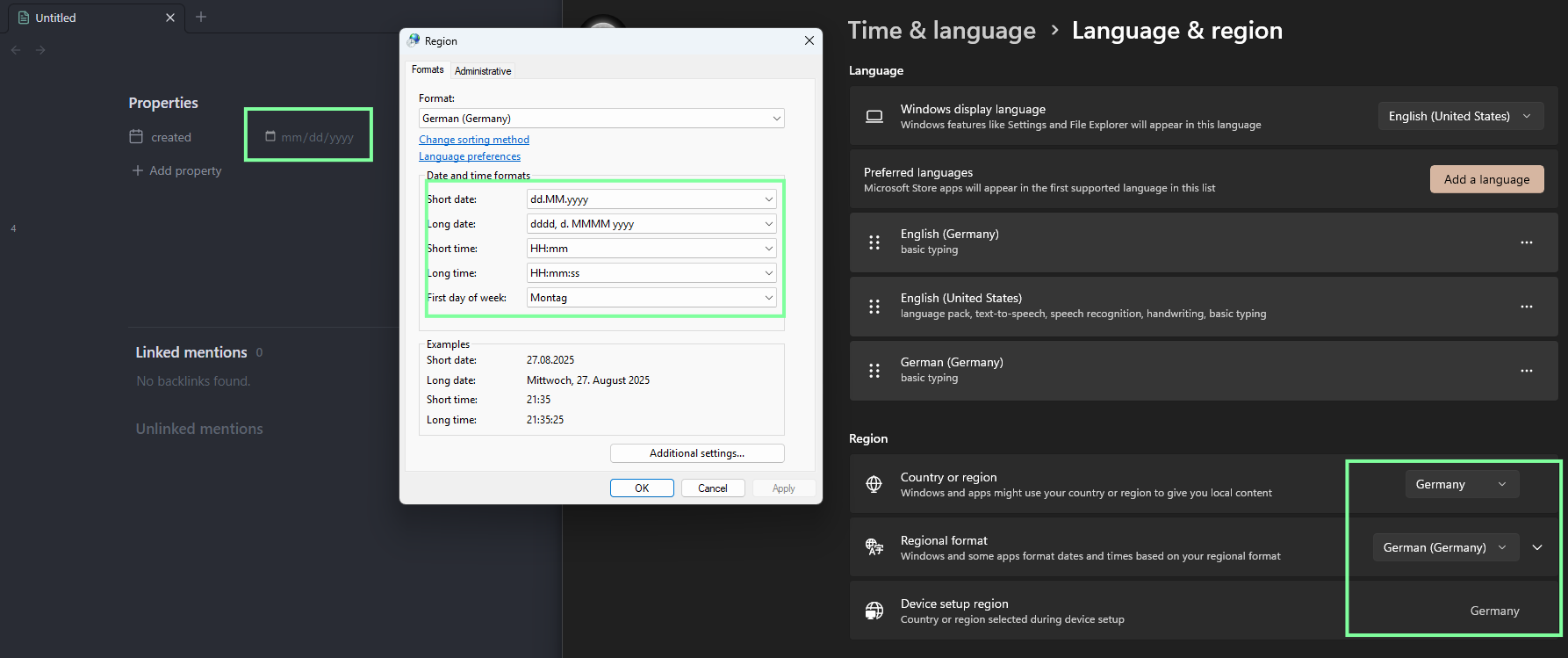

I’m using Windows 11 with the system language set to English, but my time and region are set to German. Despite this, Obsidian still displays dates in the MM/DD/YYYY format.
It would be very helpful if Obsidian allowed users to configure the date/time format directly in the settings, instead of relying only on system defaults.
