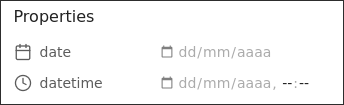

With Linux it looks like this. So, is it a Chromium bug? My language is English whereas my date format is German. Perhaps Chromium uses the standard date format for the selected language instead of the date format independent of the standard format of the selected language?

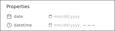

Linux: Obsidian seems to ignore LC_TIME variable. Instead, it follows LANG variable.
~$ export | grep UTF
declare -x LANG="en_US.UTF-8"
declare -x LC_TIME="cs_CZ.UTF-8"
Note example:
created: 2017-04-25T18:52:00
updated: 2024-07-12T15:53
Obsidian displays the datetime as “04 25 2017, 06 52 PM”, which is the US style.
Once I changed LANG=“en_GB.UTF-8”, the date is displayed European style: 25 04 2017, 18 52".

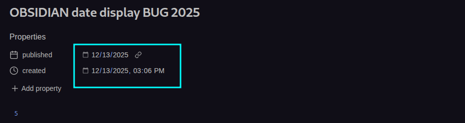

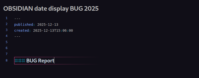

t’s a live-view issue of the property:
If your switch to YAML/source-view the date should be displayed correct, only in the live-view it’s incorrect:
Live-View Property:
YAML/SOURCE VIEW:

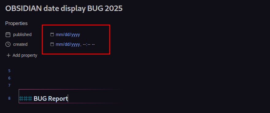

3. Open (or create) a note with a Property of type “Date” or “Date & time”. Notice, that the date format follows the locale set in LANG, not the one in LC_TIME:
4. Close all instances of Obsidian and run the same test again, this time with the locales swapped, to confirm that it indeed is the LANG variable that is being followed.
LANG=es_ES.UTF-8 LC_TIME=en_US.UTF-8 obsidian
The date format should follow the LC_TIME locale (possibly with a fallback to LANG)
The date format follow the LANG locale.
