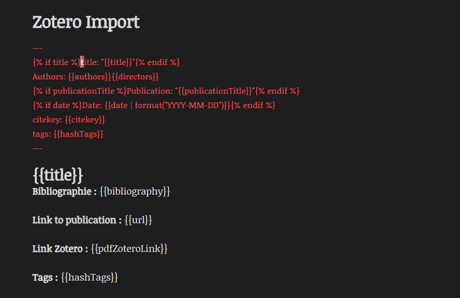

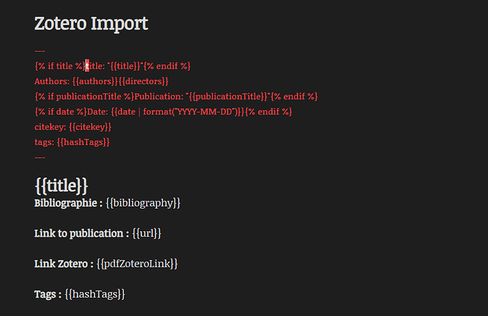

Hello everyone, I have had a problem with Zotero Integration for some time now, the plug-in. I have been trying to create a template that would allow me to automatically import into Obsidian what I highlight from documents on Zotero. It worked fine at first, but then it stopped working. When I use the import command it no longer creates the file with the clipboard on Obsidian. Checking the template I noticed that the title t is highlighted in red? could that be the problem and if so what is it? do you have any ideas?
Hey there, I’m not using Zotero integration but Citation. I happened also for this other plugin to have all the text getting red. I don’t know for you but in my case it came from the symbole “:” that it didn’t like. I was then deleating manually the “:” an re-writing it manually. Then the red text disappeared.
The red part is certainly not the issue. That’s just Obsidian indicating that the template itself, before being applied, doesn’t have valid YAML. This should be a non-issue, so long as the template produces valid YAML when applied.
Most likely, you need to update the Better-Bibtex addon in Zotero, or Zotero Integration itself. But without further details, it’s hard to determine exactly what the issue might be.

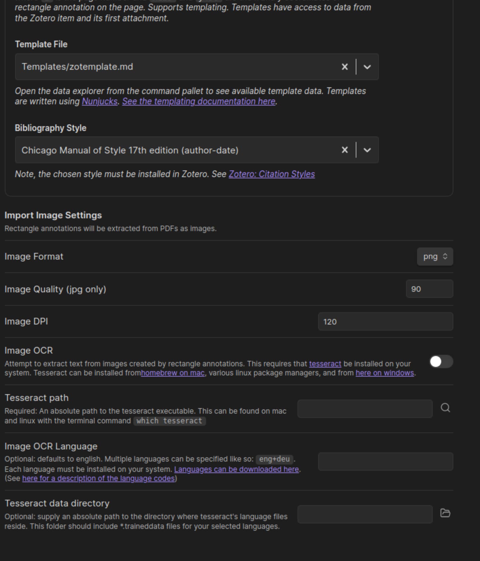

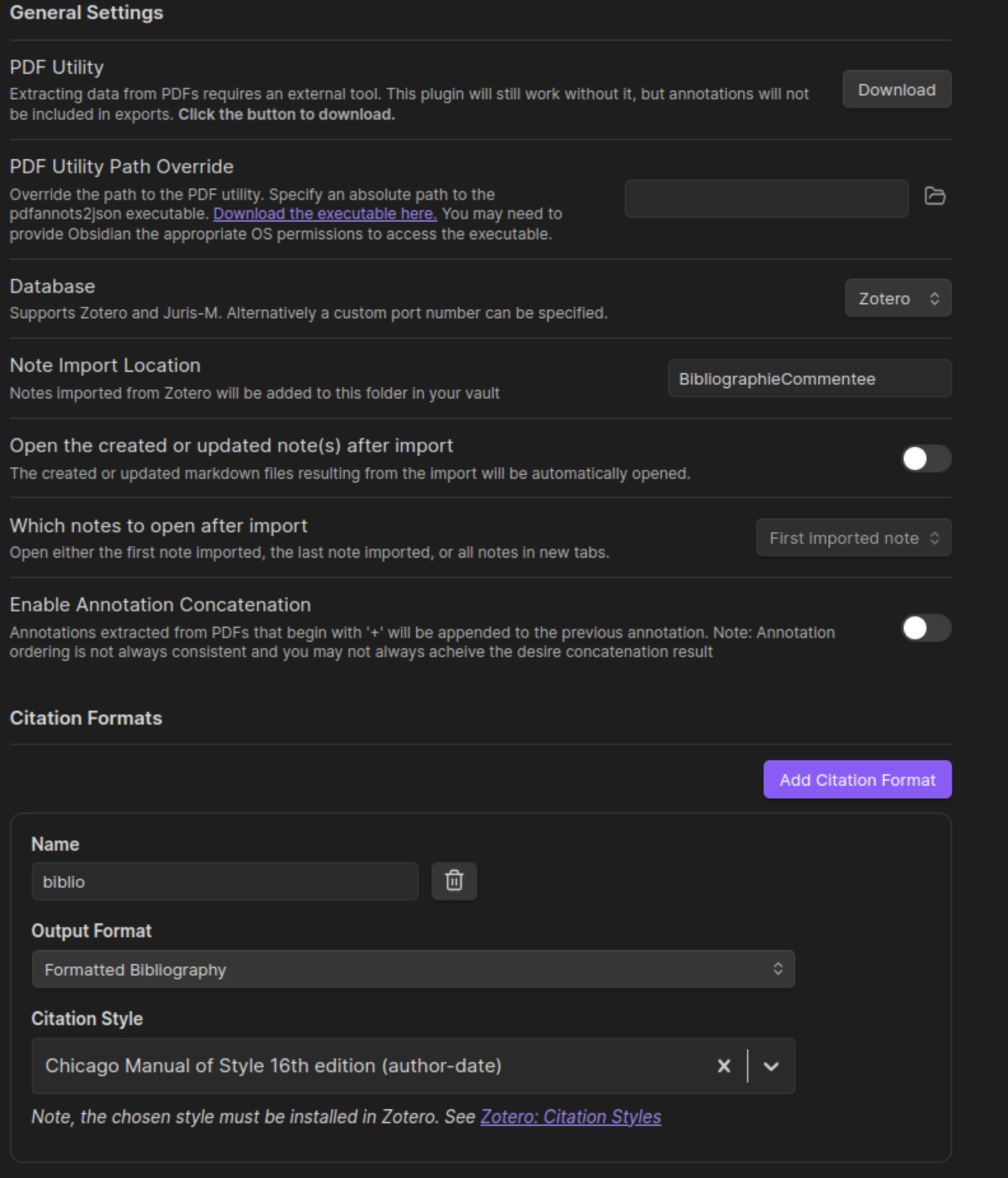

  4. Can you share a screenshot of your import format settings?
  5. And please confirm that the command you are trying to use matches the name of the import format.

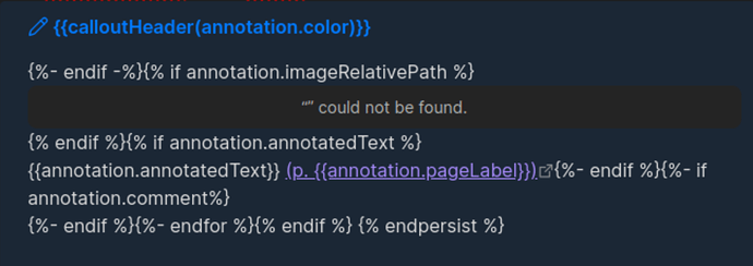

Here is an error message in my template that was not there before :
here are my settings:
