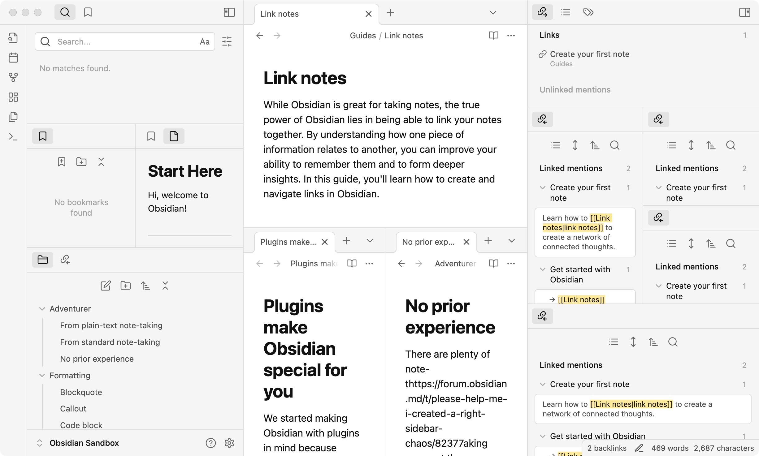

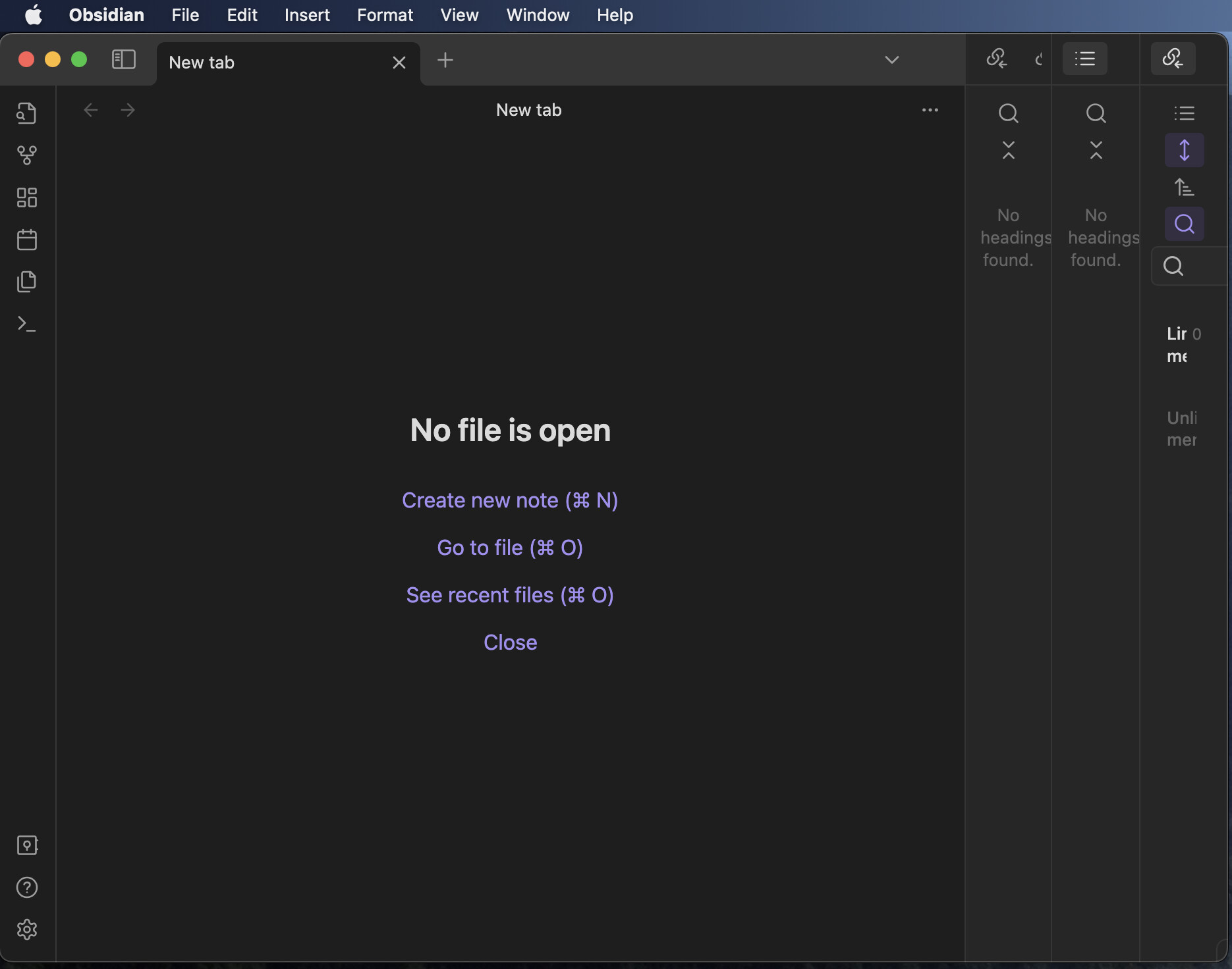

Please help me: I created a right sidebar chaos
I have accidentally made a triple right sidebar and find no way to revert it.
I am absolutely new to Obsidian, but I am bold and simply try things out. So I kind of click on every button and check what it does.
This went more or less fine until I wanted to customise and/or change the content of the right sidebar. I found “split right” under “View”, and it actually created two (same) sidebars.
I tried to find a way to make it one sidebar again. I searched but I found nothing. So I clicked again on “split right” in the weird hope that it might revert what I did - and now I have three sidebars (which I don’t want).
OK, I can hide them (fold them), but they are still there. I know it and it bugs me.
Yurcee, thank you for your recommendation. I forgot to mention that I work on a Mac.
However, you kind of told me, that “split right” cannot be undone, correct?

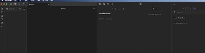

Maybe I am using wrong expressions. I am talking about the 3 columns at the right side of the screenshot. Originally, it was one.

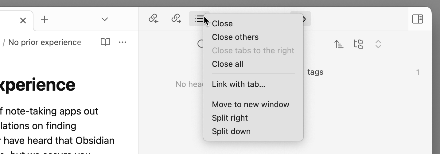

split right can be undone, by pressing the ‘x’ as on any other tab group note

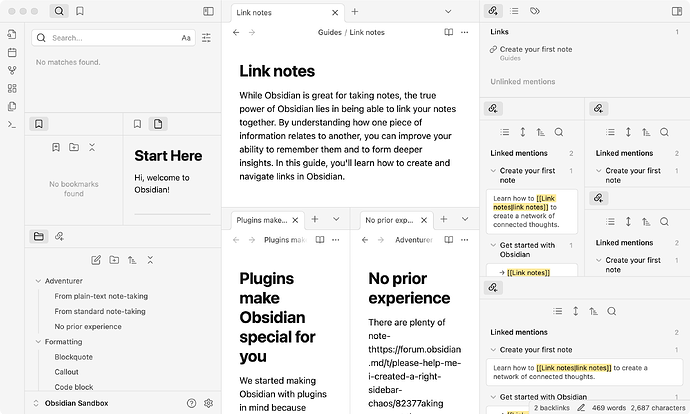

You can simply click and drag on the icons to rearrange things. You’ll see a little coloured preview. Drag it beside the other icons in the other sidebar. Once the sidebar group is empty, it should disappear.
In this gif, I have a tab inside the middle part where notes go. But it should work for you in a split sidebar too.
obsidianArrangement

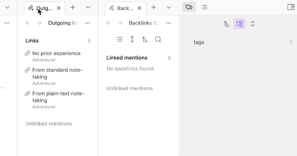

There is no x in the sidebar. I guess it’s a bug, indeed, as this sidebar shouldn’t split at all (as far as I understand the function of it.
I tried to split the tab, and this works great (and did exactly what I was searching for: to be able to view several tabs/canvasses at once). I accidentally split the sidebar where you can sort items etc., see screenshot.
I really think it’s a bug as even the icon to toggle the right sidebar disappeared. I have to use the View command “toggle right sidebar”. Then all three fold away, and the sidebar icon appears again.

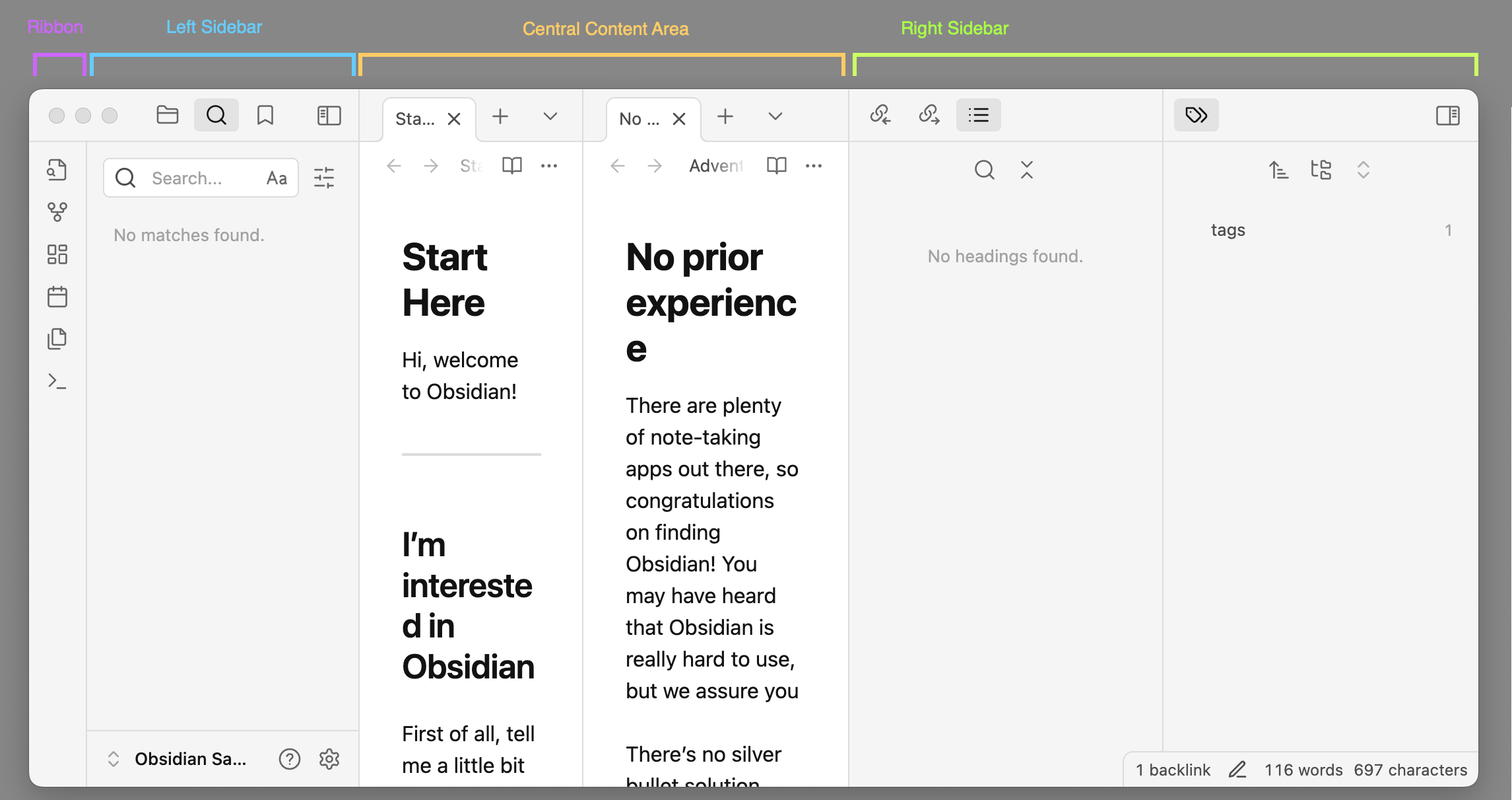

The Workspace has four main elements: Ribbon, Left Sidebar, Central Content Area, Right Sidebar. Each of them can be rearranged.
The Ribbon only contains icons. The Sidebars and the Central Content Area can contain multiple Tabs. It is possible to close and open and split and rearrange those Tabs. It is possible to move Tabs from one area to another.
In your case, you can move the icons around within the sidebar.
Or you can close them with a right click on the icon. (Tested with Obsidian Desktop 1.6.1.)

MANY THANKS!!!
This pic showed me how to close the extra sidebars. I am really grateful.
