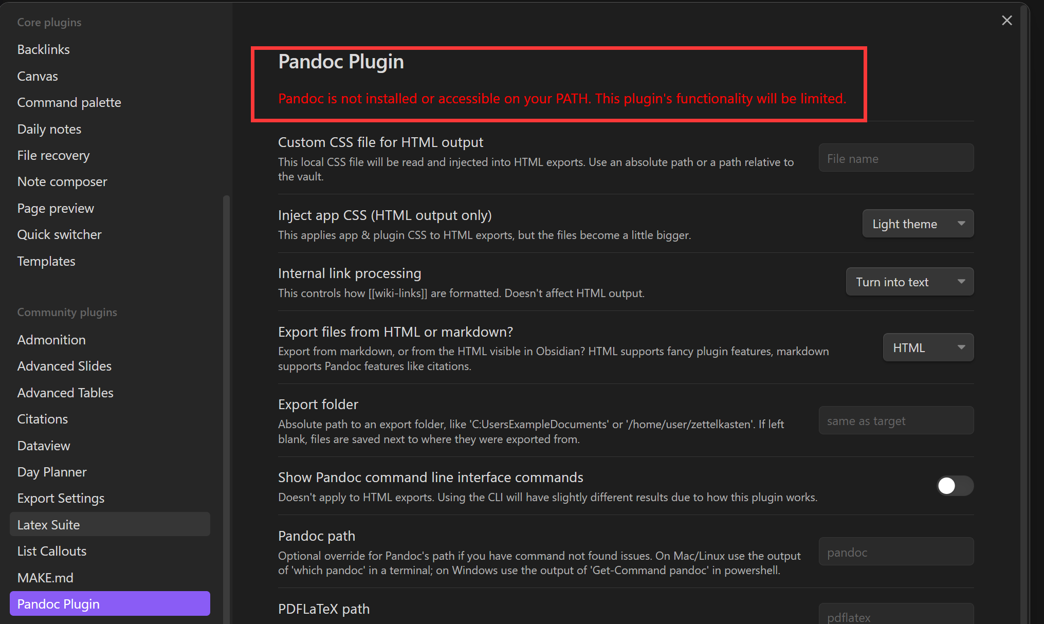

l am trying to use pandoc to export file between different formats. l installed pandoc plugin directly from the obsidian community plugins. But it showed the below image:

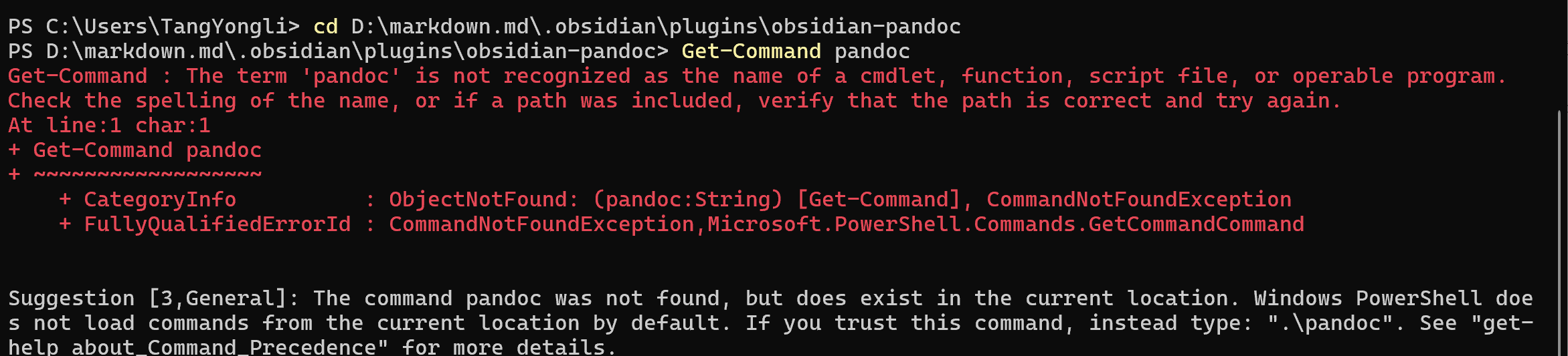

According the guide in pandoc ,l type Get-Command pandoc in powershell, but it seems pandoc is not recognised.
Maybe one bug with pandoc, l uninstalled the pandoc in obsidian, and downloaded it directly from github, still in vain.
l use windows11. Does someone has the experience to fix it?
You have to install Pandoc as well:
https://pandoc.org/installing.html
Could that be it?

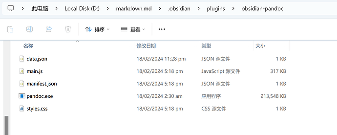

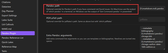

l put the pandoc binary file into obsidian-pandoc plugin directory, like below:

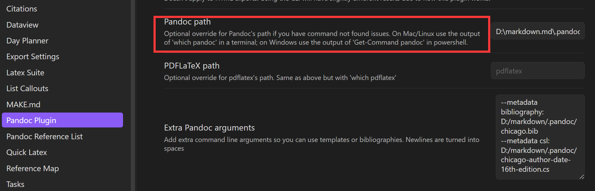

l fill the Pandoc path as below:
but the command pandoc is still not found. Whether l need extra setting?
You seem to be conflating Pandoc and the Pandoc plugin. You don’t need the latter when using Enhancing export. Also, you don’t have to specify the Pandoc path.

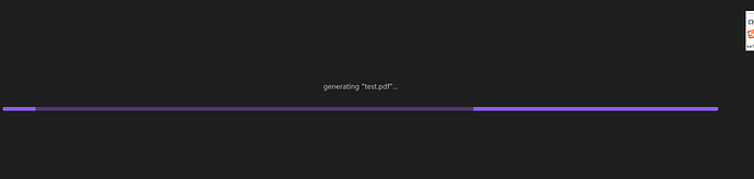

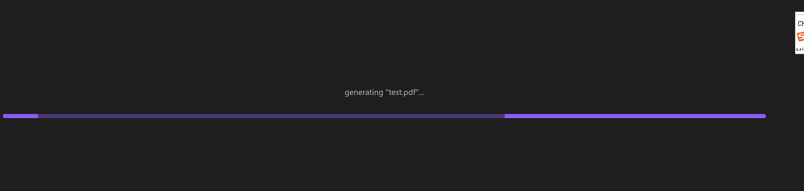

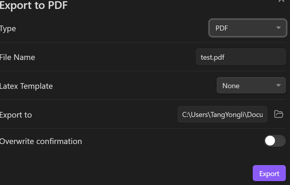

l also use Enhancing export. Yet, After l config the page, the Export progress keeps,without output.
The progress bar keeps as below.
l don’t know where is wrong with. lt’s a little frustrated. Maybe l should learn the knowledge about pandoc carefully.
That’s not how you install Pandoc. Didn’t you use the MSI installer you can get from @ariehen 's link?
Also, I recommend sticking to Enhancing export to avoid the bugs associated with the Pandoc plugin, which hasn’t received an update in years.
Yesterday l just used the zip from @ariehen 's link, now l use the MSI installer .l can find the path from powershell. Thanks!

specifically, only when l fill the Extra agrument it fails to export. Does the export setting below has something wrong? Although l can export without the agrument, but the bibliography loses.
pandoc "D:/markdown.md/zotero/test.md" --citeproc --csl "D:/markdown.md/.pandoc/chicago-author-date-16th-edition.csl" --bibliography "D:/markdown.md/.pandoc/chicago.bib" -o "D:/markdown.md/zotero/test1.doc"

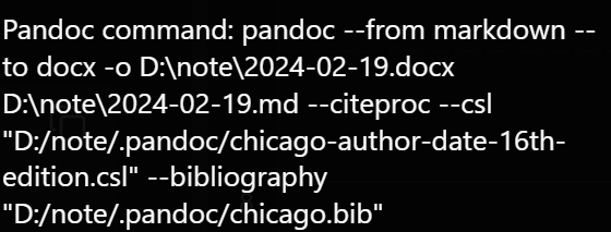

  2. the command is below

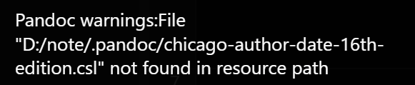

  3. the error in console is below
    l don’t know what’s the resource path. Pandoc is installed by default on system C
    . My vault is D:/note.
Are you sure the file paths are correct for the CSL file? Also, you have a mix of slash types. Try using backslashes rather than forward slashes. If that doesn’t work, try using a = between the arguments and their associated paths.
