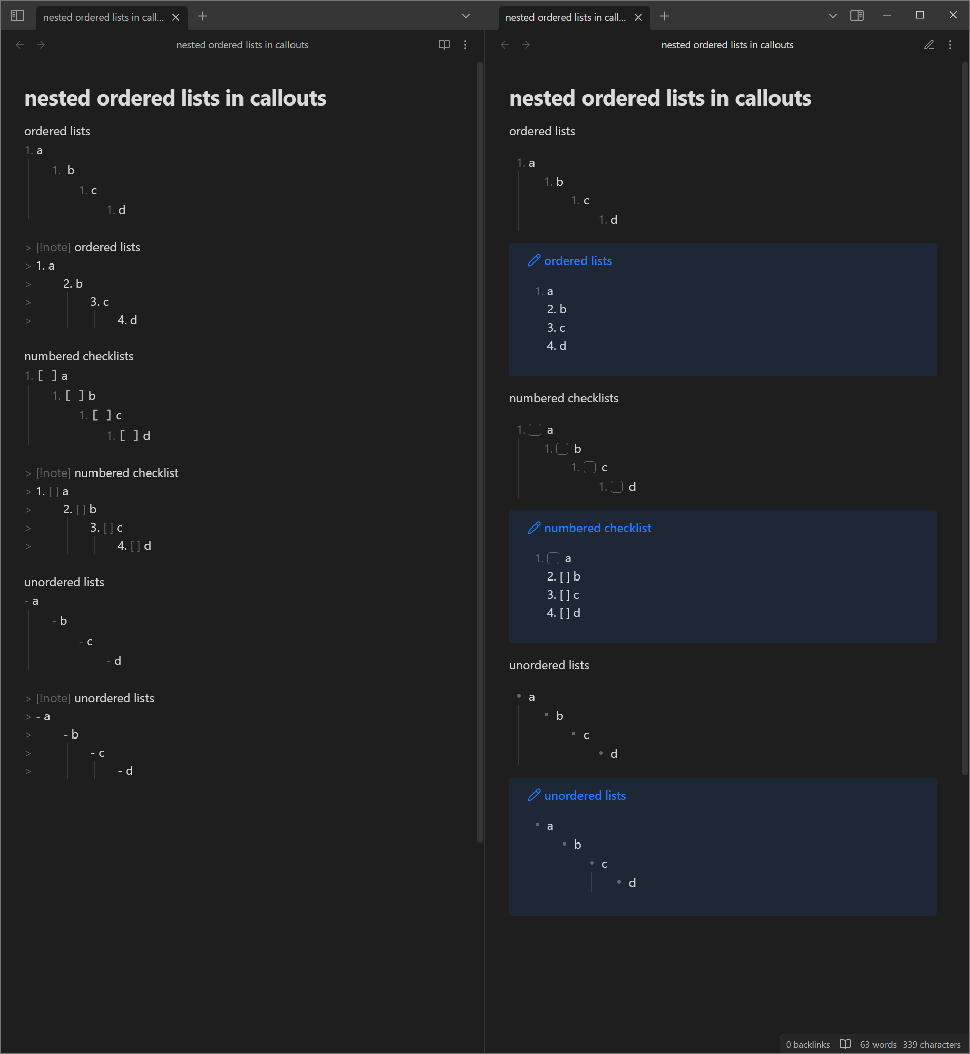

Can anyone tell me why this is happening in Reading and Live Preview or how to get around it? Or is it a bug? It worked fine for me until the recent update.
Nest ordered lists in a callout
Paste this into a note in the sandbox:
ordered lists
1. a
	1.  b
		1. c
			1. d
> [!note] ordered lists
> 1. a
> 	2. b
> 		3. c
> 			4. d
numbered checklists
1. [ ] a
	1. [ ] b
		1. [ ] c
			1. [ ] d
> [!note] numbered checklist
> 1. [ ] a
> 	2. [ ] b
> 		3. [ ] c
> 			4. [ ] d
unordered lists
- a
	- b
		- c
			- d
> [!note] unordered lists
> - a
> 	- b
> 		- c
> 			- d

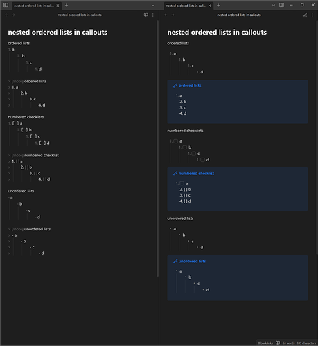

In the callouts (in both Reading and Live Preview), the ordered lists have no nesting. Instead, they appear as if they are simply follow-on lines without indentation, yet their auto-numbering continues:
The inspector shows that they’re not rendering as list items:
Unordered lists render properly. Ordered lists that are not in callouts are also fine.

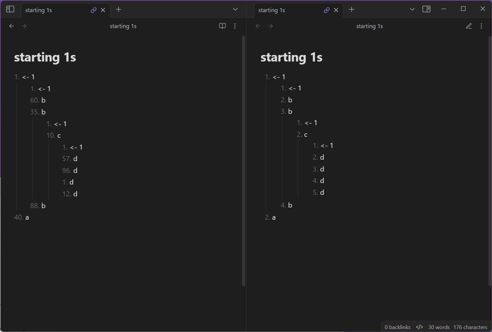

I think I’ve narrowed down the symptoms: Any nested level that begins with a number that isn’t “1” is being interpreted as a continuation of the previous list item. It’s in Reading and Live Preview, both inside and outside of callouts. Here’s what does and doesn’t appear as expected…

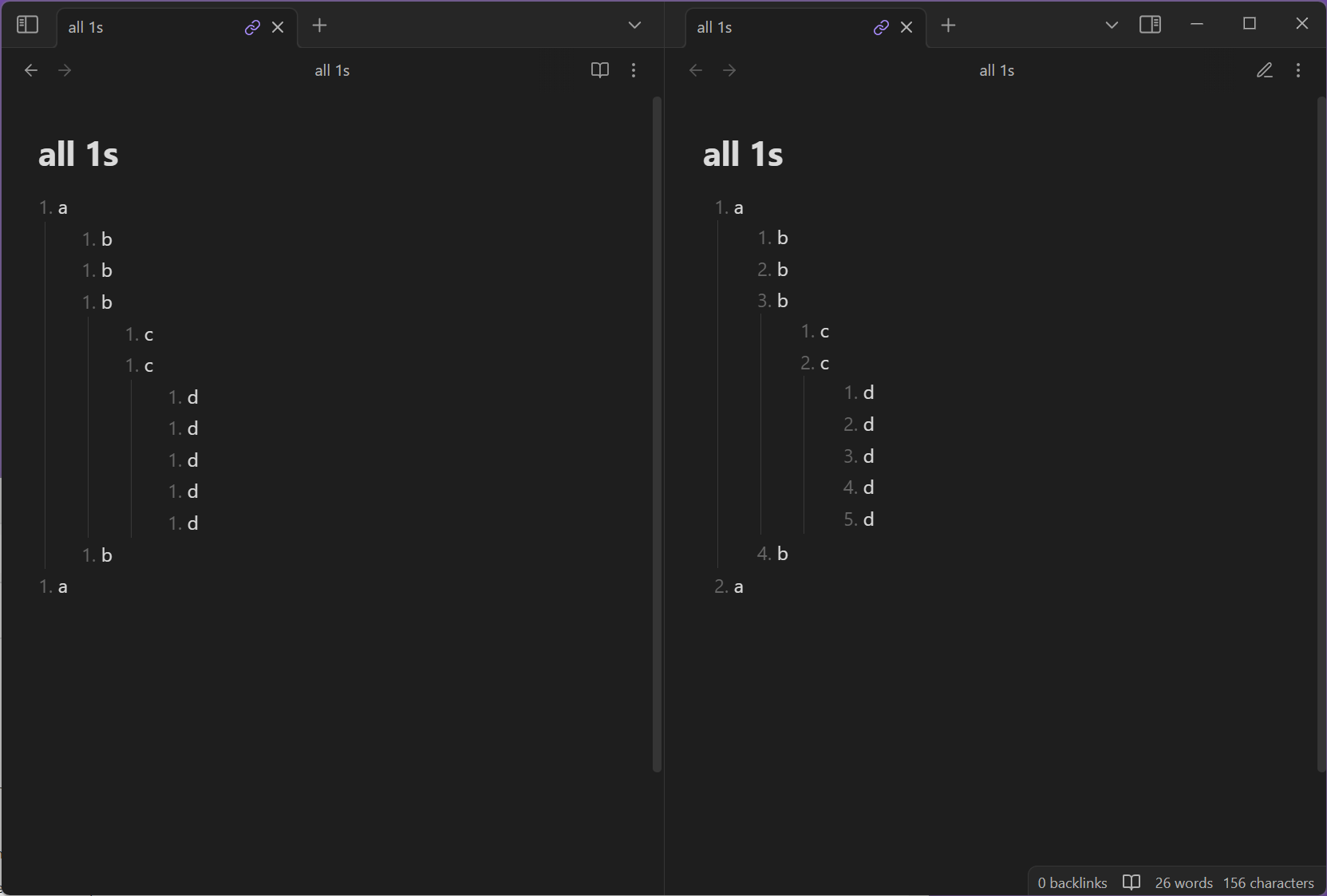

Nests and auto-numbers appear as expected when I number every line as “1”:
Summary
1. a
    1. b
    1. b
    1. b
        1. c
        1. c
            1. d
            1. d
            1. d
            1. d
            1. d
    1. b
1. a

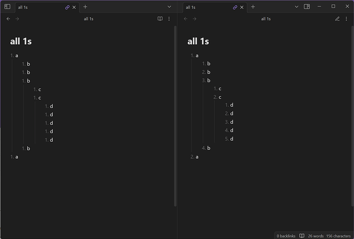

The same result happens as long as the first item at each level is a “1”. The rest of the numbers don’t matter:
Summary
1. <- 1
    1. <- 1
    60. b
    35. b
        1. <- 1
        10. c
            1. <- 1
            57. d
            96. d
            1. d
            12. d
    88. b
40. a

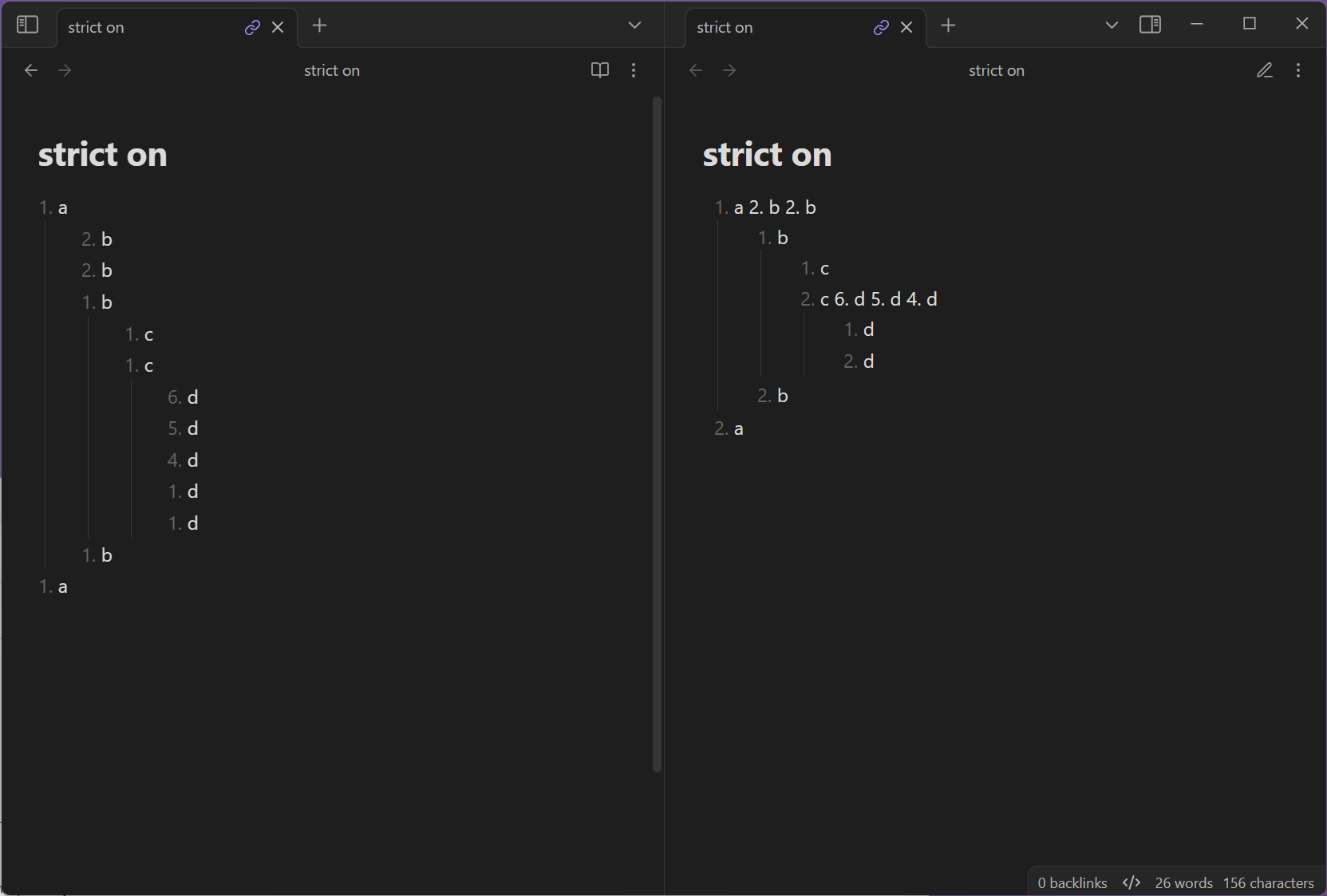

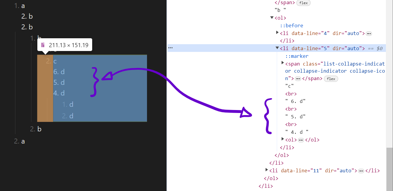

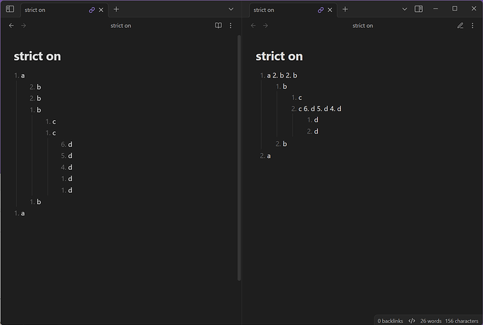

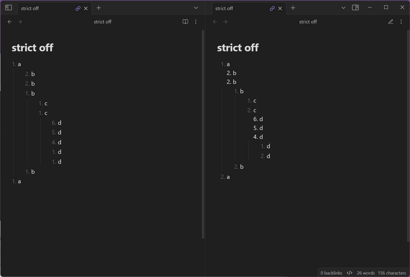

However, a level that begins with any number that isn’t “1” is interpreted as a continuation of the previous list item. The inspector can confirm this. Toggling “Strict line breaks” is also telling.
“Strict line breaks” on:
“Strict line breaks” off:
Inspector:
Summary
1. a
    2. b
    2. b
    1. b
        1. c
        1. c
            6. d
            5. d
            4. d
            1. d
            1. d
    1. b
1. a
So, is this a bug? Or is this just the way of the world? … for nested ordered lists.
