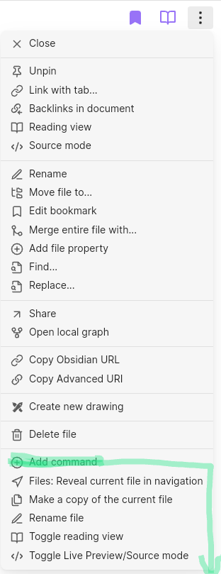

Hi there,
thanks a lot for your help and the screenshots.

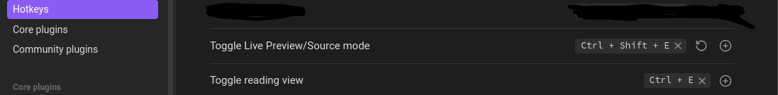

The hotkey for toggle reading view I have too, but the other toggle for Live-Preview / Source mode I don’t have. ![]()
So it seems to be a device-problem. The windows version seems to have the most features.

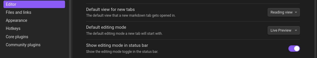

For the lower right thingy, here is a screen shot of the lower right of my Obsidian window:
Right now it shows the pencil icon indicating live preview, and since I clicked on it, it also shows the toggle next to live preview with the option of going directly to one of the other two options.
Hopefully, this translates good into your German(?) version. Not sure whether the iPad looks very different, but these screen shots are from the Mac version.
Update: Regarding the hotkeys, you should be able to go to Settings > Hotkeys, enter “view”, scroll to the bottom of the list, and hit the plus icon next to the “Toggle Live Preview/Source mode” line, and enter your hotkey combination if it’s not set already. Do note this toggle is still only available when you’re not in reading mode.
