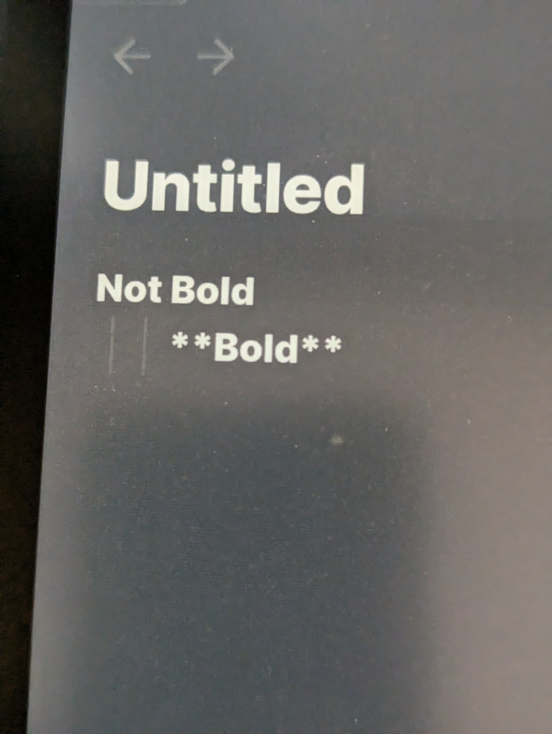

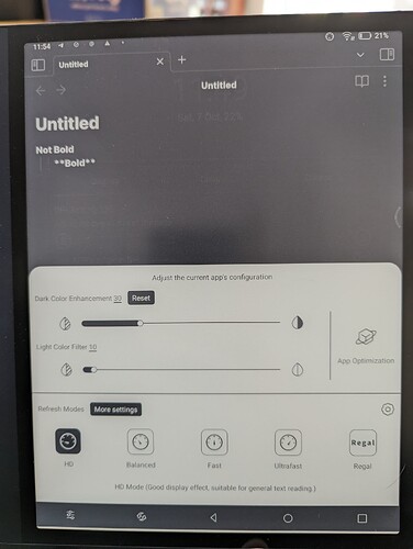

I type this:
I see this:

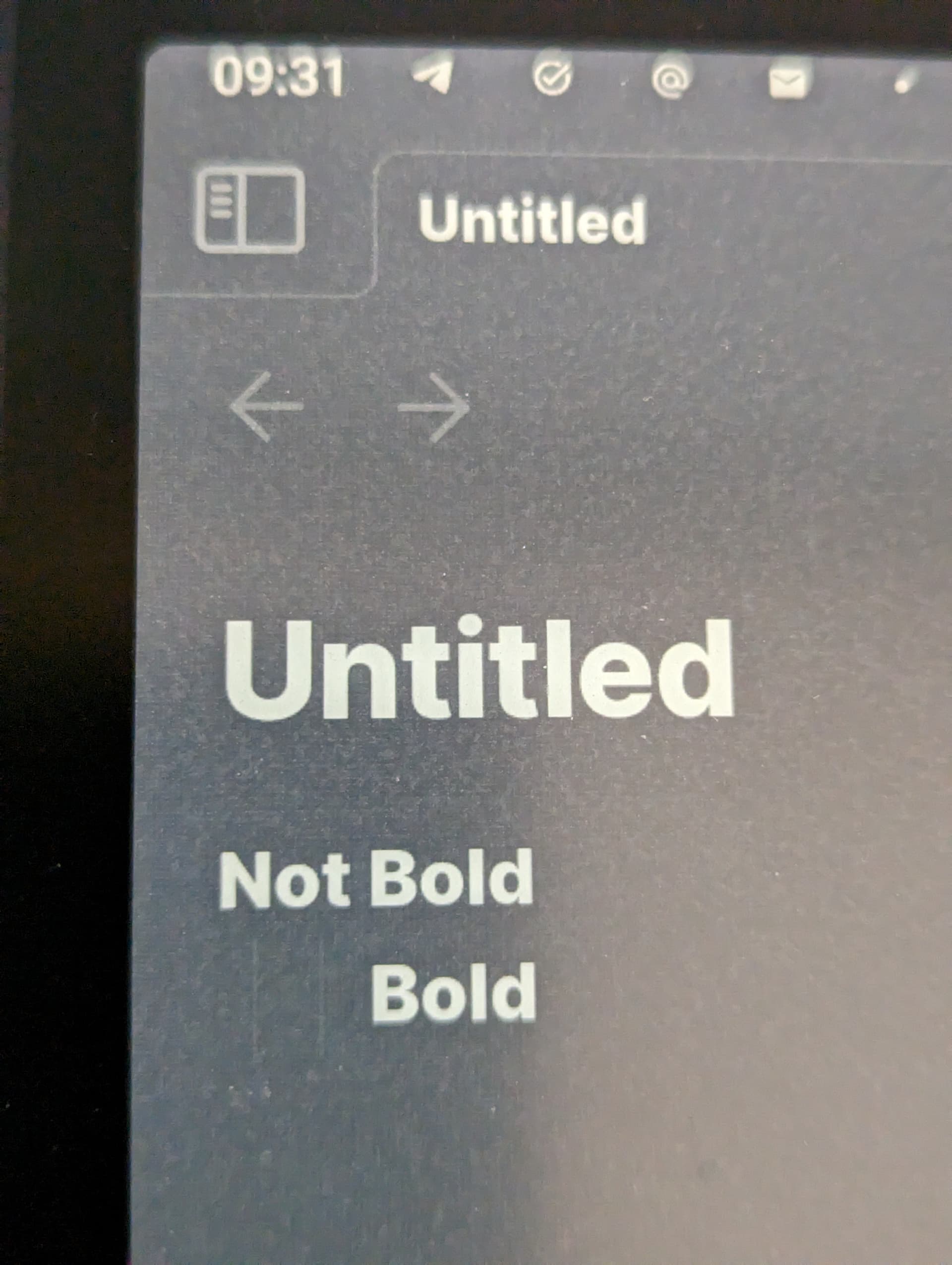

Update: That was quick. I had already done almost everything under Troubleshooting, but I double-checked everything and made sure I had done it all.
No difference.
If I could see the code I might be able to fix it (I used to do that for $$ until recently). But Obsidian is not that kind of project.

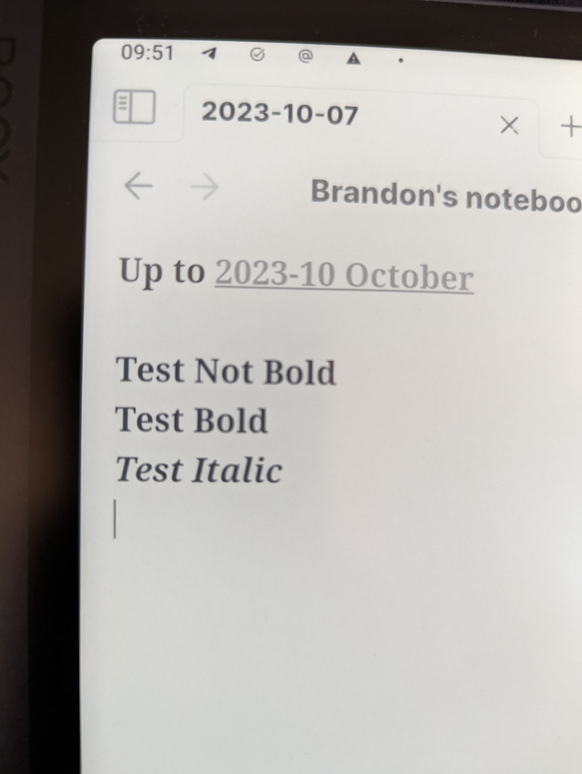

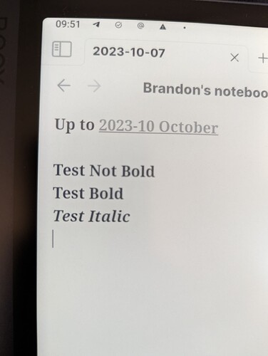

Italics appears to work as expected.
I have installed Obsidian on my Android phone (Pixel 7) and on Windows, and neither appear to have this issue. It might be some setting on the Boox (Tab Ultra, B&W). I am investigating that now, and I shall report back.

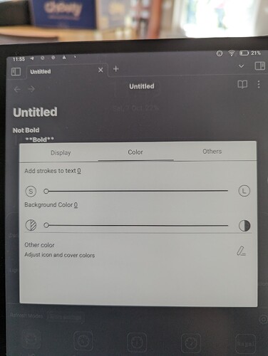

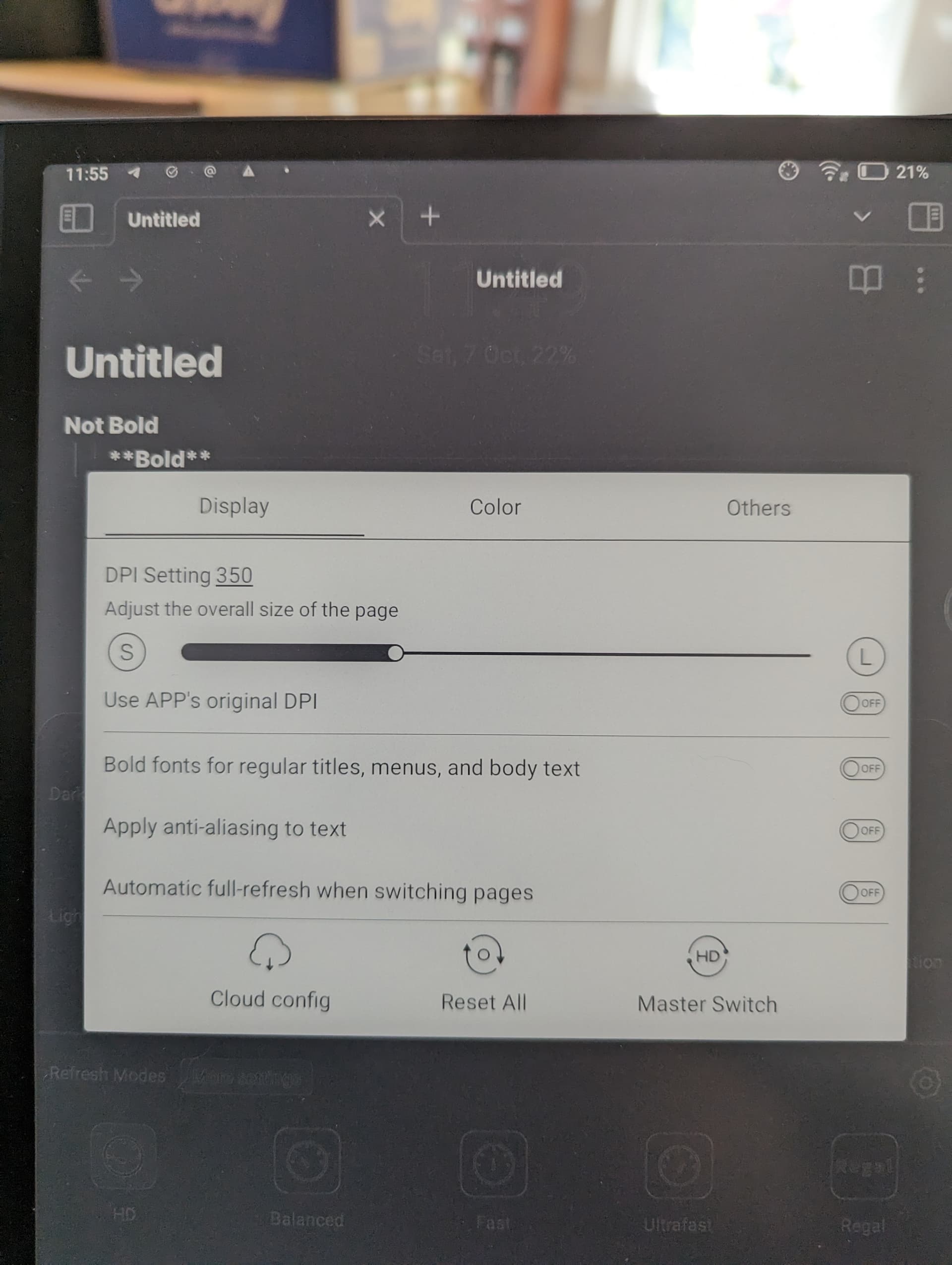

This was a setting on my e-ink tablet, rather than an Obsidian issue. But for future folks who may run into this, here is how I solved it:
  1. Open a vault in Obsidian.
  2. Click the “E-ink Settings” icon in the bottom toolbar.
  3. Click the “App Optmization” logo in the upper right corner of the dialogue. It does not look like it should be clickable. It looks like a decorative logo. But click it.

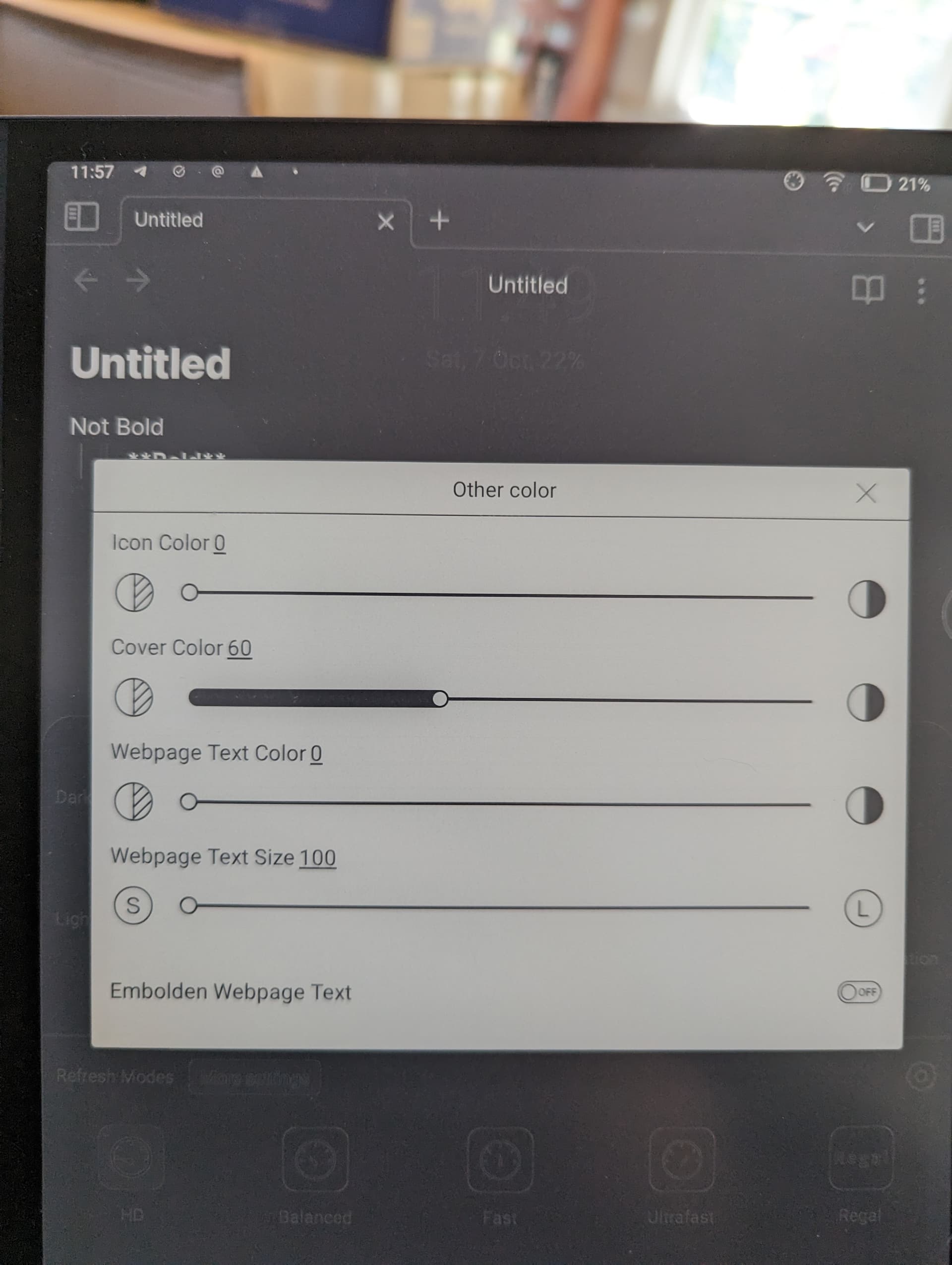

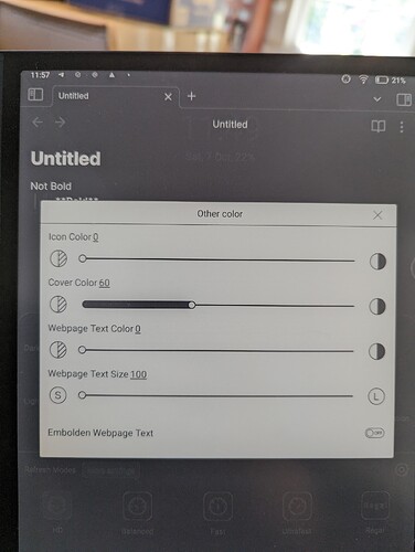

  4. Click the “Color” tab.

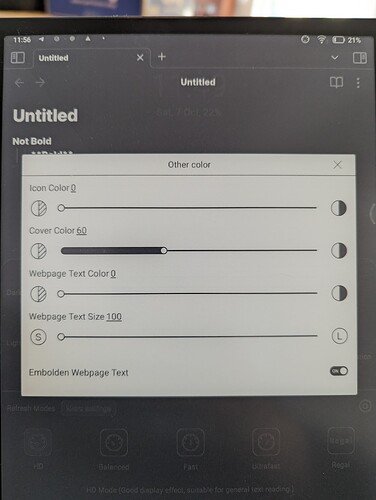

  5. Click “Adjust icon and cover colors”.

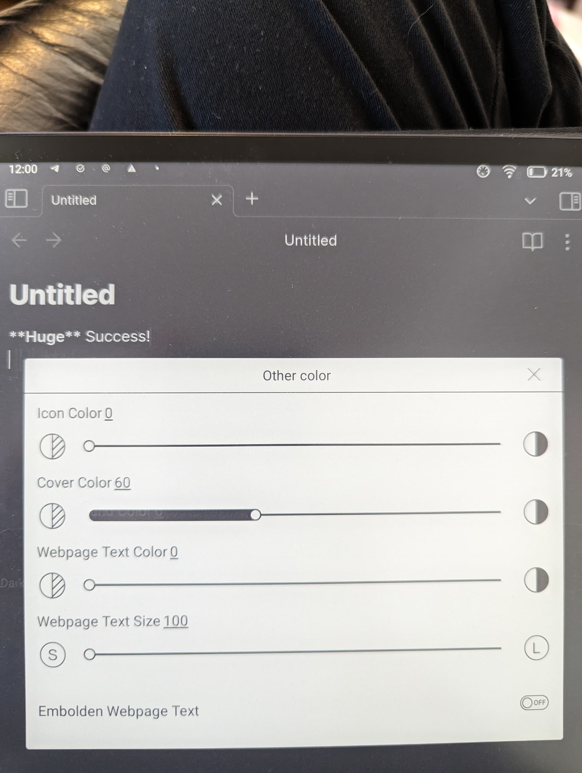

  6. At the bottom of that dialogue, UN-click “Embolden Webpage Text”.
  7. HUGE SUCCESS!
