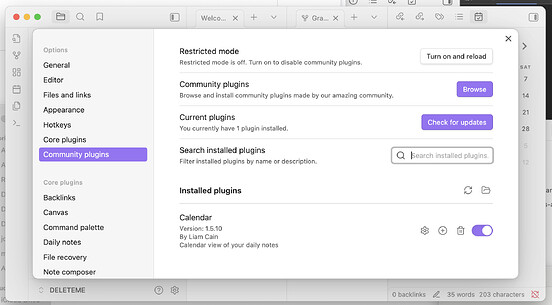

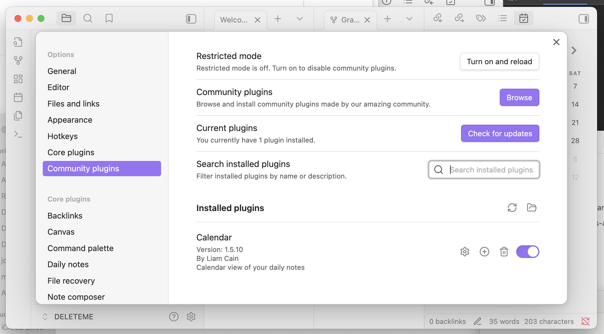

I took these steps:
  1. downloaded Calendar’s main.js and manifest.js files from here: Release 1.5.10 · liamcain/obsidian-calendar-plugin · GitHub
  2. disconnected from wi-fi/LAN
  3. created a new Obsidian vault
  4. created a {VAULT-NAME}/.obsidian/plugins/ folder
  5. created a {VAULT-NAME}/.obsidian/plugins/calendar/ folder
  6. placed Calendar’s main.js and manifest.js in the calendar folder
  7. reloaded Obsidian
Calendar was listed and I could enable it without any errors, all offline.
I would double-check your folder names are correct and you have the necessary files in their proper place. That’s the only thing I can think of at the moment.
