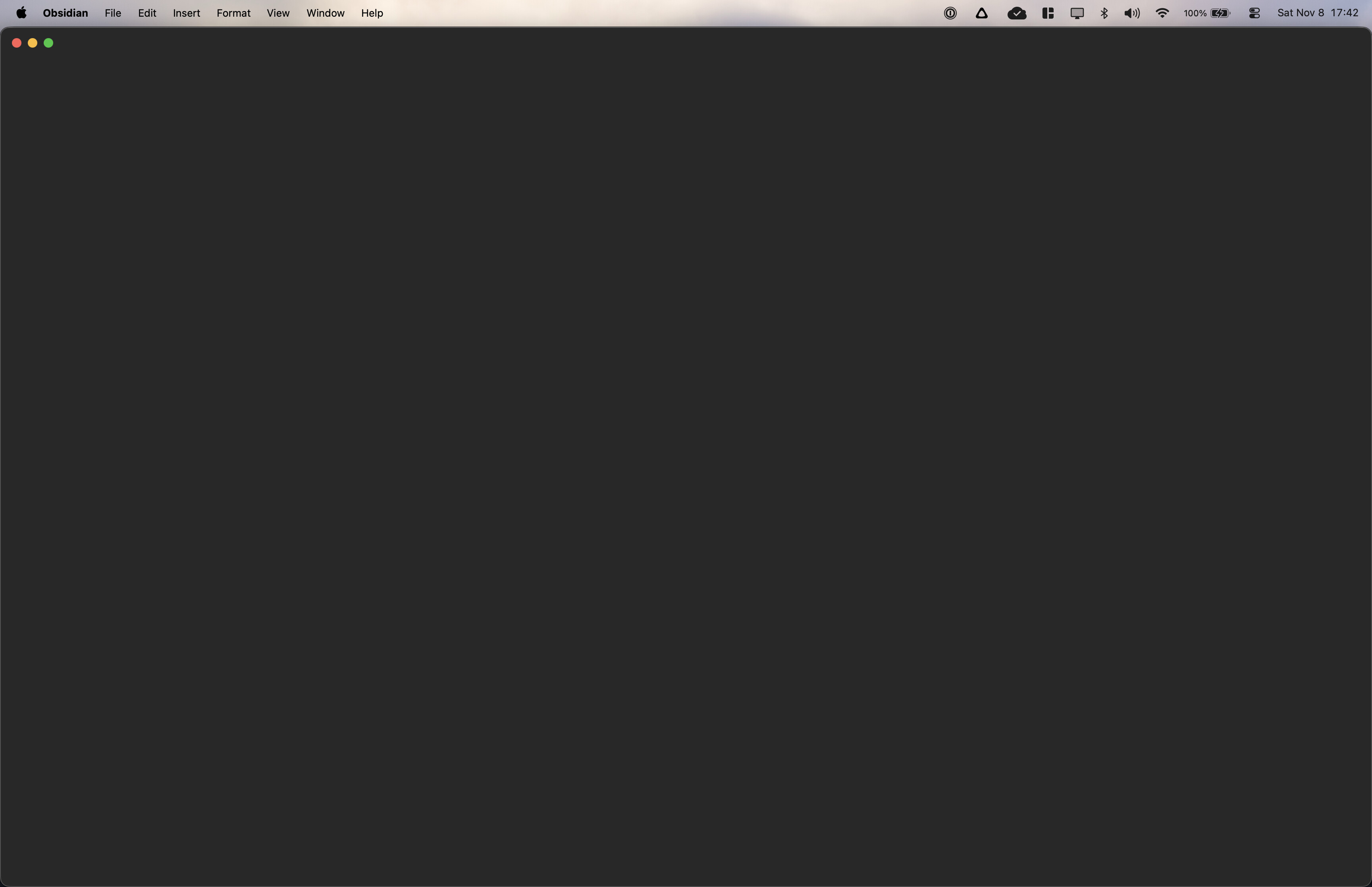

Last night, I decided to update my M3 Max to the new Tahoe 26.1. Obsidian loads just fine, but after a few minutes, the box goes gray. I have disabled all plugins (only a few incorporated) but the issue persists… Are there any known conflicts with the installer, app or core plugins we don’t know about?
Screenshot of the Drama :frowning:

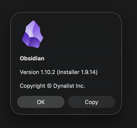

What’s your Obsidian installer version ? :thinking:
There was an Electron update shipped with 1.9.14 meant to fix an upstream Electron bug (generally) affecting MacOS Tahoe users :blush:.
Edit: If you’re using other Electron based apps (Discord, VS Code, etc…) and they didn’t update Electron yet, they could potentially also have some impact on Obsidian (I think :innocent: )
It was an older installer and the issue showed its ugly head. So, I updated the installer hoping that would fix, but its still there.
About Obsidian
Version 1.10.2 (Installer 1.9.14)
