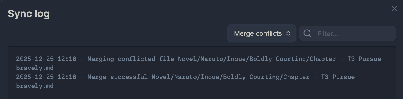

The sync log does show merge conflicts. I would attribute this problem to sync because if I quit the mobile app and I open it again, it will still have the same problems. but if I go to airplane mode it will stop having those problems.
