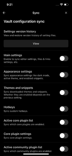

I hadn’t connected to a remove vault in a while, so I couldn’t remember the default settings. I just connected to a remote vault from a device that wasn’t previously connected to that vault, and all the Vault configuration sync settings (at the bottom of Settings > Sync) are all off by default. These settings need to be set per-device.
If you haven’t toggled these on yet,
  1. I’d make a backup of the {VAULTNAME}/.obsidian settings folder on your device that you want to sync the settings from (just to be safe).
  2. If they aren’t, enable the settings you want to sync on that device and fully restart Obsidian. You can check the sync activity/log to see what .json settings files were uploaded.
  3. Enable the settings you want to sync on your other devices and restart Obsidian on each device.
