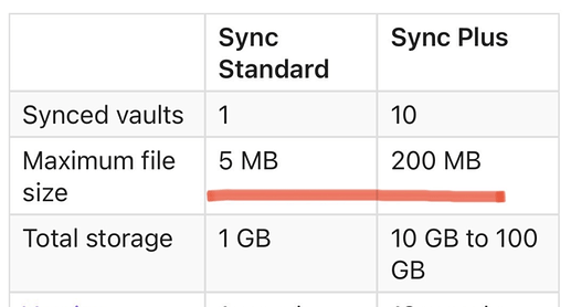

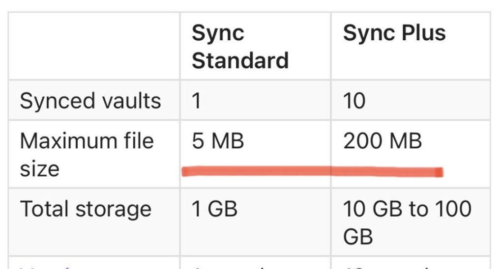

What Sync plan are you using and how large (in MBs) are the PDFs?
https://help.obsidian.md/sync/plans
That is the solution to my issue. I thought that my PDF files needed to be under 200mb. Actually I was paying for the Standard Sync not the Sync Plus.
All my PDF files were above 5mb and that was my problem.
Thank you for highlighting this.
