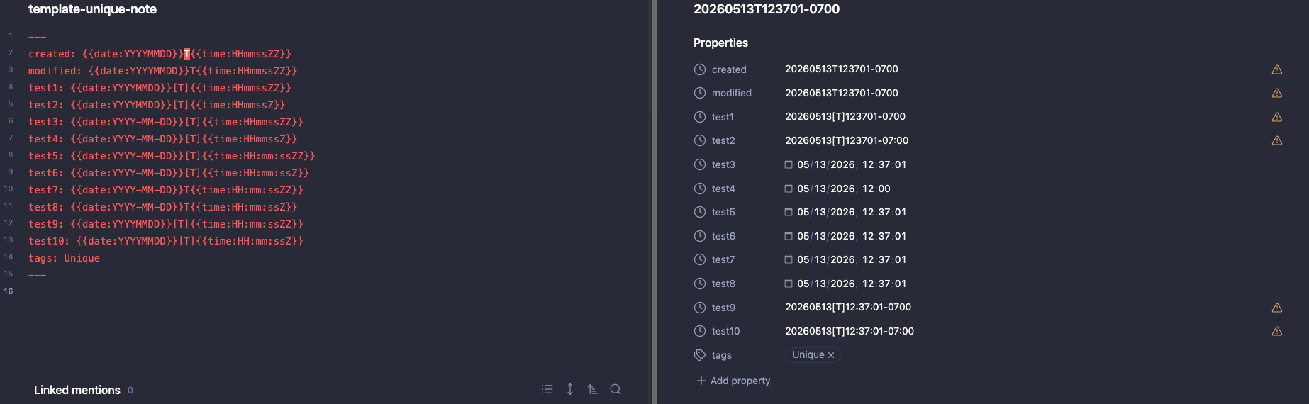

I updated my templates to include the time zone in valid ISO 8601 format. I’ve tested various valid ISO 8601 formats for file naming and frontmatter. Some of them parse correctly by Obsidian, while others do not.
Obsidian doesn’t seem to support valid ISO 8601 with time zone offset and doesn’t support UTC date and time (UTC±0000).
e.g.:
Note the highlighted T, a false positive error message: “Syntax error. Your frontmatter is invalid."
result:
Note the modified date time is not parsed, a false positive error message: “Type mismatch. Expected Date”
These are all valid ISO 8601 formats which should be correctly parsed in frontmatter:
{{date:YYYYMMDD}}T{{time:HHmmssZZ}}
{{date:YYYYMMDD}}T{{time:HHmmsszz}}
{{date:YYYYMMDD}}T{{time:HHmmssZ}}
{{date:YYYY-MM-DD}}T{{time:HHmmssZZ}}
{{date:YYYY-MM-DD}}T{{time:HHmmsszz}}
{{date:YYYY-MM-DD}}T{{time:HHmmssZ}}
result (after manually setting the property type to date time):
Note the modified date time is not parsed, a false positive error message: “Type mismatch. Expected Date & time”

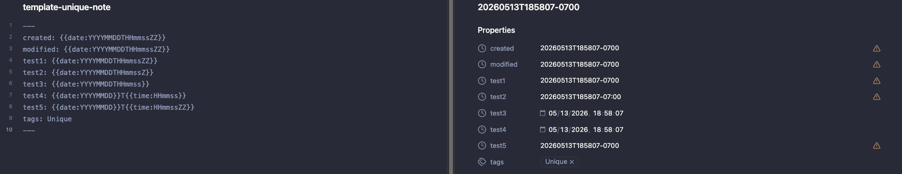

More test cases with results:

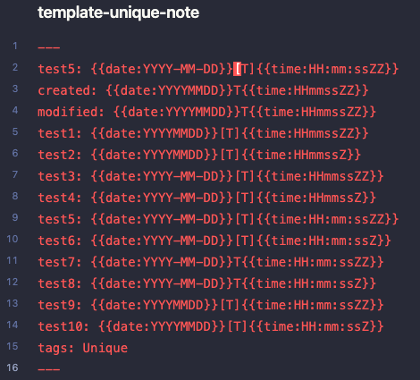

Also note the syntax error, this false positive error applies to any first occurring ISO 8601 property regardless of T or [T]:
I am going to review this when I get to my desk.
One quick note, your screenshot are not actual dates, they are templates.
The red is is for the template. Because a template is not valid YAML.
Test actual dates.

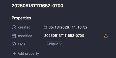

I can’t test all of these at the moment, but this is the format I use
created: "{{date:YYYY-MM-DDTHH:mm}}"
and it shows no error (red YAML), with or without quotes, in my main template note.

@WhiteNoise thanks, I realize this. It’s the processing of the templates that’s broken. If we don’t change or fret over the property type being Date/Date & time instead of Text, then it’s less of an issue–more of a UX thing. Though test4 above is an oddball with the time processing incorrectly.
@Pch it doesn’t display a syntax error for all the errors. Only the first occurring syntax error.

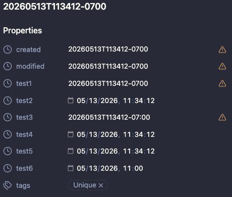

Obsidian just doesn’t seem to know how to correctly process timezone offsets correctly, including for UTC according to the full ISO 8601 standard:
This sort of thing matters if/when multiple people across different time zones are sharing and working on a vault together.
