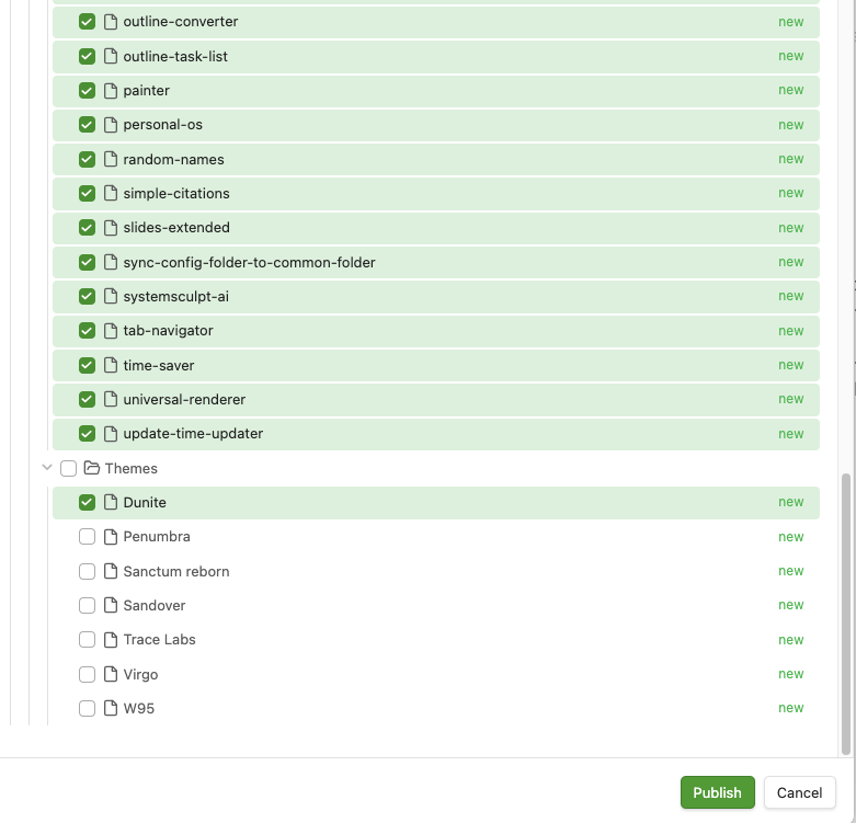

For info: I noticed this morning when publishing the Obsidian Hub that the last few new notes created this week - all of which have publish: true - were not selected… It take a lot longer than usual to work out what to publish…

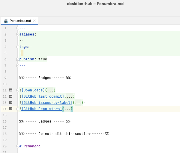

Here is one of those unselected ones, with its publish: true value:
Is there some kind of timeout on the checking process? Or maybe the vault was still indexing the few hundred changed files I had just pulled from GitHub.
It still happens most weeks.

  • Click Publish again, and select the last 1, 2, 3 or 4 files that were not published the first time.
Earlier on, I used to expand the tree structure of new files in the Publish dialog, but it’s quite heavily nested and super fiddly to navigate down to double-check that the last of the new or changed files is selected…
Clicking Publish a second time is a much quicker workaround.
