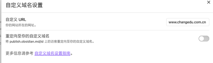

I try to configure obsidian with my own domain “changedu.com.cn”, but for now about 2 days is still didn’t work.

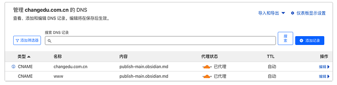

configure cname

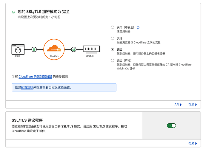

configure SSL

configure cname
configure SSL

changedu.com.cn works
www.changedu.com.cn/ doesn’t work.
You need to follow all instructions here
Thank you very much. I change obsidian’s config from changedu.com.cn to www.changedu.com.cn, then it work for me now.
Now changedu.com.cn is broken, remove the www from your Obsidian settings, and follow the instructions in the blue Note callout here: Set up a custom domain - Obsidian Help
