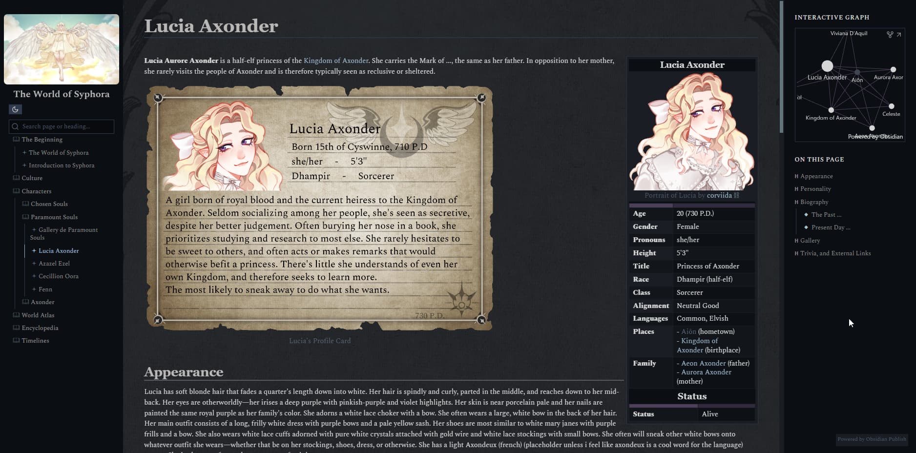

Hi there! This is a bit complicated, but I’ve been trying for the past two days to figure out how to add a custom background image to my obsidian publish page. Two very helpful topics from ~4 years ago helped me get it almost perfectly.

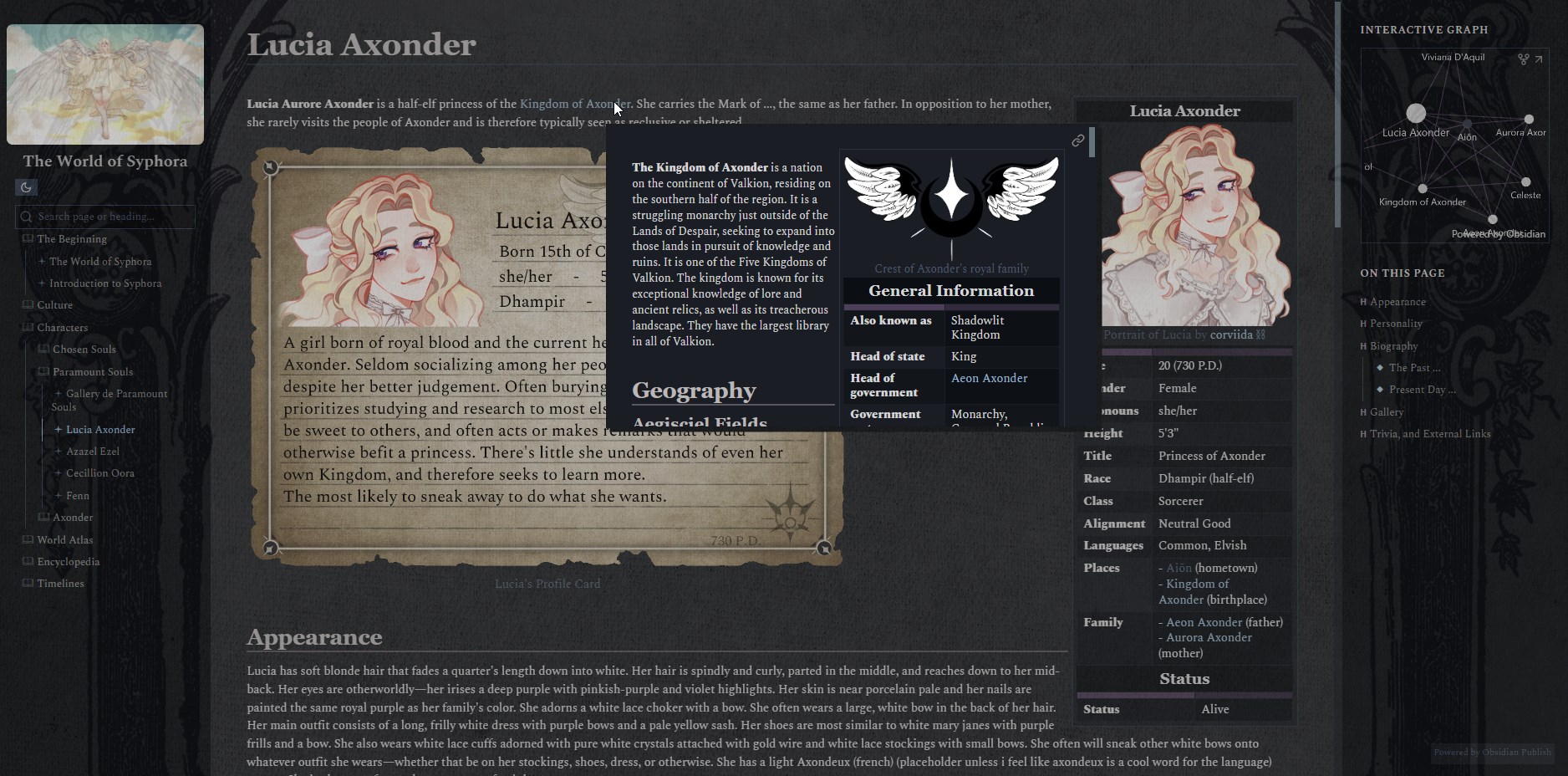

The biggest problem I’m facing is that for some reason hover preview essentially freezes the website aside from the viewing box, and the code from the topics I found just outright do nothing on obsidian publish.
I’m using a custom publish.css taken from the ITS theme, and then adding the following code to the bottom
and this is the only code I’ve found works, which you can see the result of in the next image
.markdown-preview-view::after {
content: “”;
position: fixed;
background-image: url();
background-repeat: no-repeat;
background-size: cover;
filter: blur(0px) brightness(50%) saturate(50%);
opacity: 0.3;
left: 0;
top: 0;
right: 0;
bottom: 0;
z-index: -1;
I would love some help, and thank you to anyone who can!
I can’t test Publish at the moment, but if you remove the above background CSS from publish.css, does the hover preview window work fine?
Sorry for the late reply, but yes the hover preview window works fine! Just for some reason whenever I have the background CSS, the hover preview seems to break it, and only the hover preview can be used. Even if I click a link, it just opens another hover preview and stays on the same page.
