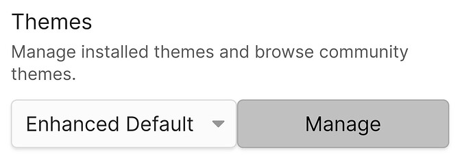

Happens in Default theme, so not theme issue

Hello.
Enhanced default is not default.
Create a new blank vault. Does it happen there?
What is your phone exactly, android version and android webkit version. Thanks
Sorry about that ! Here’s how it looks with Default theme
