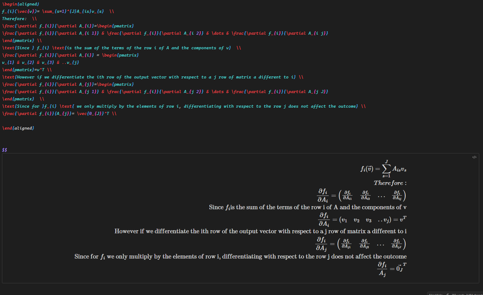

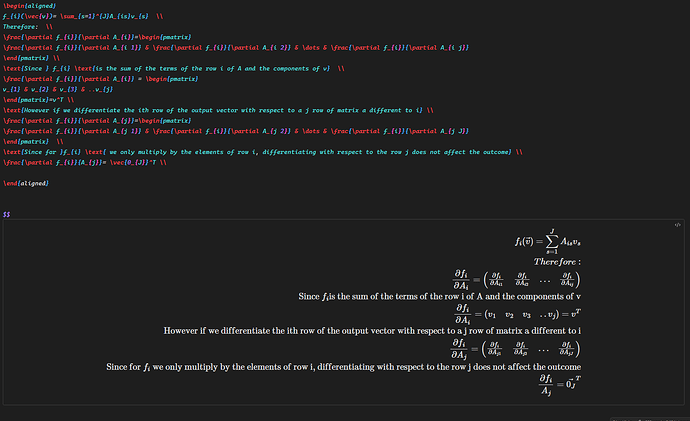

Obsidian math block's align aligns right instead of left
I want the text to be aligned to the left , for every line to start on the left and if any is too big grow to the right.
Here is the code i am using :
I have tries as some posts suggested to anchor the code with & but it “deletes” the line I put it in and the format is unreadable. I have also changed align for aligned, flalign*

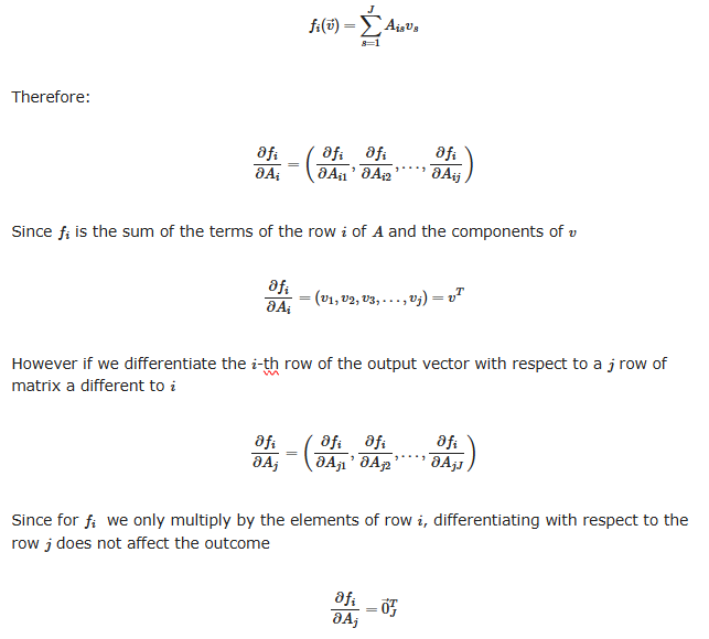

This produces the following output. Note that every $$ block is by default horizontally centered:
The centered display of equations is standard practice in math and science books and papers, so it looks ok to me.

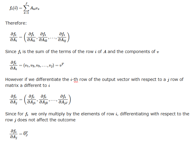

But, if you insist on having all left-aligned (which, in my opinion, looks worse), you can use this css snippet:
.math-block .MathJax {
    text-align: left !important;
    display: inline !important;
And then, the result would be:

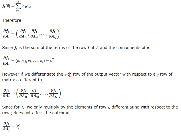

I think that at the very least a small left indentation for the displayed formulae would be necessary to make them easier on the eye. For example:
    margin-left: 1em !important;
Result:
