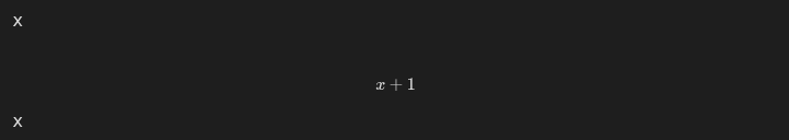

This source
x
$$ x+1 $$ x
renders as
and there’s definitely an extra blank row after the first x. Do you also see this?
yeah, i see that also. not sure why it happens. in any case, the extra line doesn’t appear if there is a line break after the closing $$, and i think that syntax is better anyway.

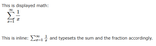

See here an example:
This is displayed math: $$\sum_{x=1}^\infty\frac{1}{x}$$
This is inline: $\sum_{x=1}^\infty\frac{1}{x}$ and typesets
the sum and the fraction accordingly.
which results in:
In case you want “big” symbols inline, you can force the displayed style, without triggering the vertical spacing, by inserting \displaystyle in the equation. Eg:
This is inline: $\displaystyle\sum_{x=1}^\infty\frac{1}{x}$
but uses "big" sum and fractions.
which gives

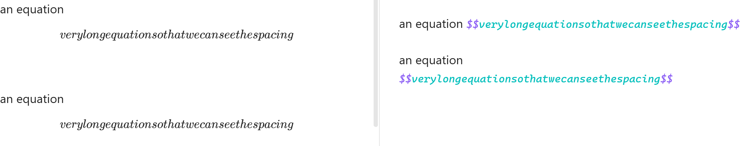

they are identical for me in both live preview and reading mode. what are you seeing? could a snippet/theme/plugin be causing the issue?
No, I use stock appimage and see this even when disabling all plugins.
Note that if you type it in, preview mode silently inserts a new line, which is probably why you don’t see it. Try pasting it in.
It’s still easy to reach this state though, and somehow I often do. See screenshot and confirmation above as proof I’m not imagining things.
you are referring to these, correct? they are both faithfully copy-pasted and they render in exactly the same way for me, on Windows. if for some reason these are not copy-pasting faithfully for you, perhaps instead of manually correcting them you can use a markdown linter to fix it.
as i mentioned before, i do see the extra line when using the unsupported syntax. however it essentially never comes up for me in my usage of obsidian.

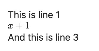

You want separate lines, without an empty line between them? Like this?
This is line 1
$x+1$
And this is line 3
