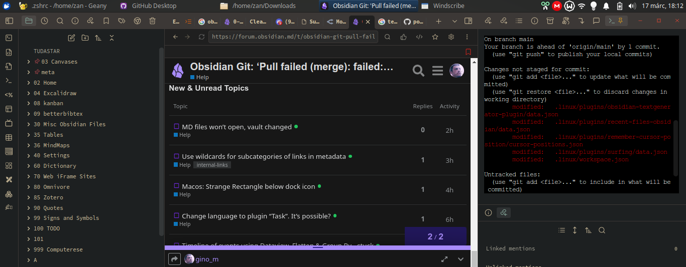

One can install the Terminal plugin and use all git commands from inside Obsidian. One can set aliases, e.g. gs for git status to make it quick.
On the plus side, one can edit files that are outside of the Obsidian vault as well.
