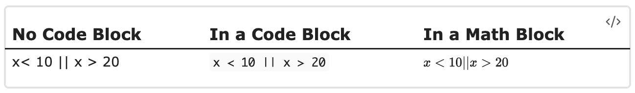

Horrible, terrible, hack :winking_face_with_tongue:
```dataviewjs
dv.table(
 ["No Code Block",   "In a Code Block",    "In a Math Block"  ],
[["x< 10 || x > 20", "`x < 10 || x > 20`", "$x< 10 || x > 20$"]]
Result:
