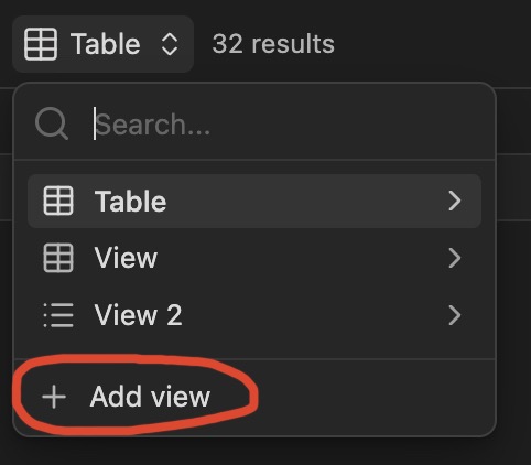

But Zodian replied to you. It is possible to make multiple views and switch between them.
At the top left corner, click on the view and then “Add view”.
Or run the command `Bases: Add view`.
And there you go. Multiple views you can switch between. Each view can have different filters and sorting and grouping. You can even duplicate existing views to make adjustments from one you like.
