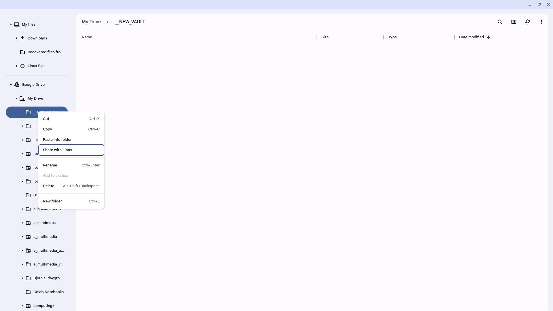

My vault is on my chromeos file system - Google Drive
I’m sharing this folder to Linux ( Right-click on the folder you want to share and select the “Share with Linux” option.)

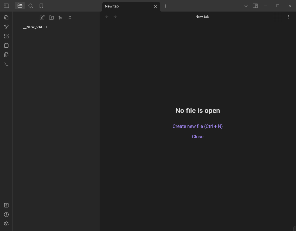

Obsidian shows my vault location: /mnt/chromeos/GoogleDrive/MyDrive/computingz/L_O_LOCAL/O/O_ichmoimeyo
Syncthing folder unsurprisingly also shows
