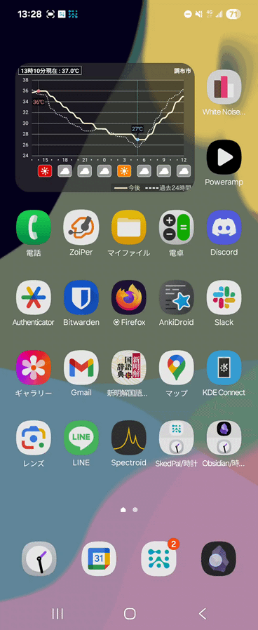

Screen recording:
  • First, I open the Obsidian android app
  • Checking the right side panel, I confirm the bug has occurred (sync is hanging on “Connecting to server”)
  • From past experience, no matter how long you wait, sync will remain stuck in this state indefinitely
  • To get Obsidian to sync, I force close the app and re-open it
  • I check the right side panel to confirm Obsidian is syncing properly again
  • Now I can start reading / writing notes safely
