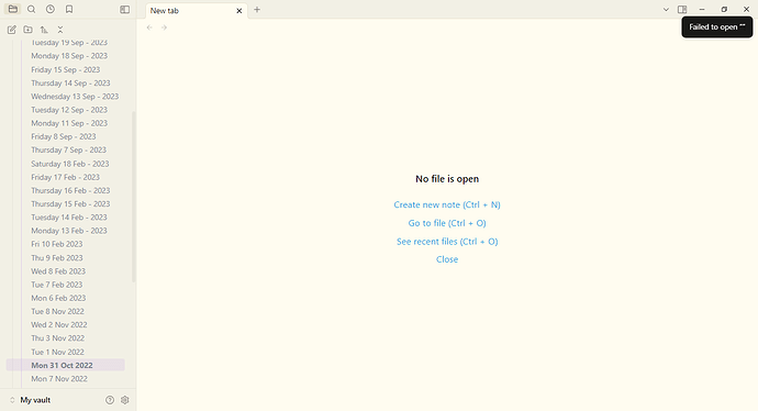

I was working in Obsidian when I encountered an issue. I tried to switch between notes, but the program wouldn’t open the selected one.
To provide more context, I was specifically making changes in Excalidraw, but unfortunately, the edits weren’t saved. When I attempted to return to the previously opened note, I received this error message. While I have a backup, I’m quite concerned about what caused this sudden problem.
Well, what comes to mind IN A BIG WAY… sounds like a bug has entered your system. REALLY! Keep your other vaults AWAY from what you’re doing FOR NOW. STop using the s/w and begin testing with a series of test files. I do that when I get into a FIX like THIS!
no file is open – i know that one…
when something is indexing or acting up in the background (my candidates: dataview and obsidian query language plugins), the editor is frozen and if you were to go to a new previously opened tab, it will have even overwritten the contents of the file on that tab you’ve switched to…
it may have something to do with some race conditions or asyncronous js bs and even with obsidian’s internal save-file mechanism
