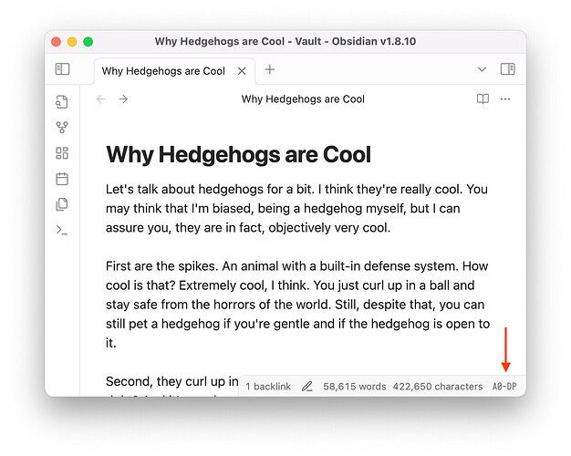

Hey there, I made a little plugin that assigns 4-character note codes to every note in your vault.
I wanted a way to refer to my notes in hand-written journals and in other things like shell scripts, but embedding full note titles or obsidian:// URIs was rather painful. So this thing lets you just use short codes in the XX-XX format.
I tried to specifically make these easy to use for handwriting, so note codes will do things like treate similar-looking characters as one and the same, meaning that AA-0A == AA-OA.
There are also some other things that’ll hopefully be useful, like the ability to quickly copy a deep link to the note with its Note Code.
Under the hood, note codes are a hash of the full note path in the vault - check out the repository README for more information: GitHub - SilverEzhik/obsidian-note-codes: Reference your Obsidian notes from anywhere with simple 4-character codes. · GitHub
And if you’re interested, you can try it our in Obsidian for yourself: obsidian://show-plugin?id=note-codes.
Have fun!
