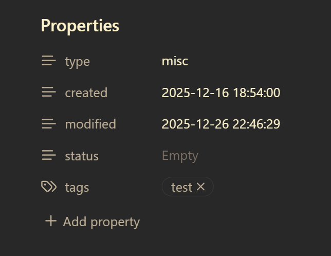

If I understand your question right, in source mode you can either do this for a list…
tags:
  - test
Or this as a single…
tags: test
In preview mode it looks like this…
It doesn’t appear a tag can be an external link […] or internal link [[…]]. Also, it seems to be easier to me to add tags and other properties in preview mode so I don’t have to think about how they are formatted.
