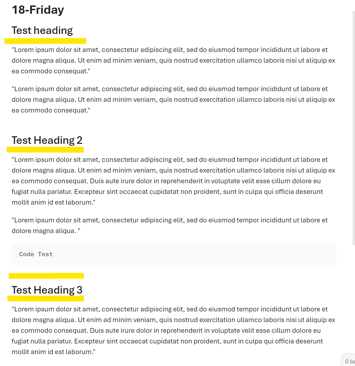

Here’s how it looks in reading mode, where there is empty space (paragraphs) between the headings and text (and code blocks and text) as expected:

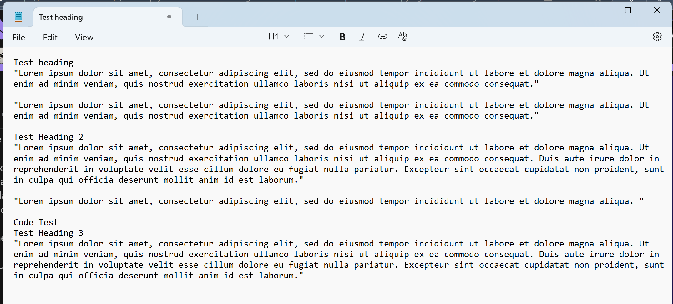

However, if you copy the text from reading mode to clipboard and then paste as plaintext, this is what you get:
Where there is no space between headings and text or code blocks and text.

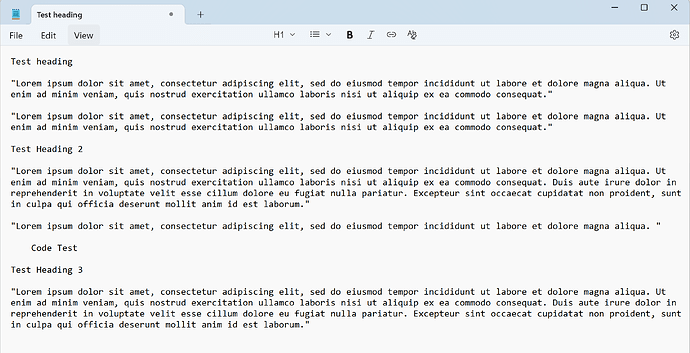

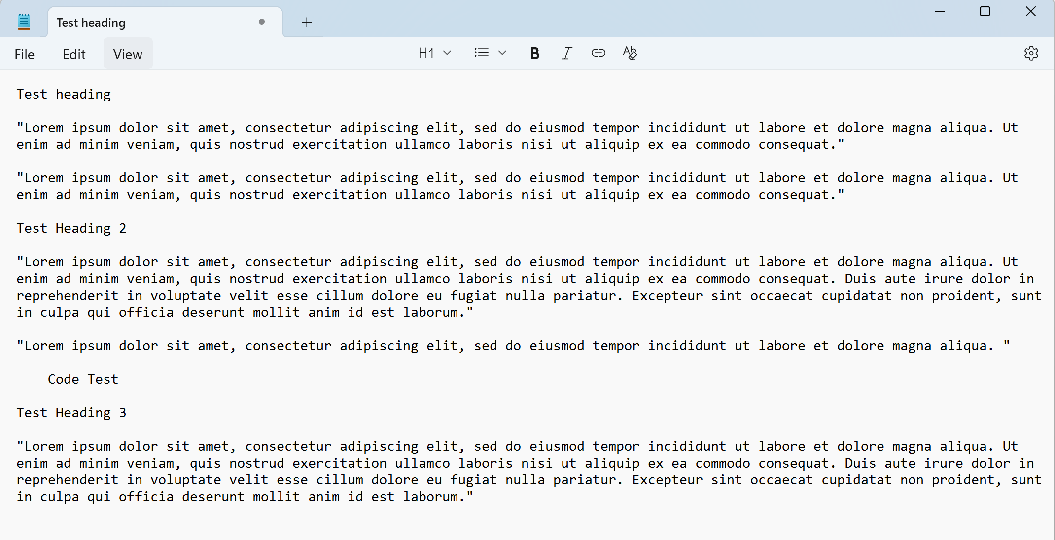

NOTE: If I open the same markdown in another markdown editor (Typora), copy to clipboard from Typora, and then paste as plaintext, it works as I’d expect:

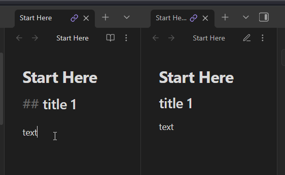

I double checked our reference markdown implementation (commonmark).
There is no difference in the HTML output between
# title
text
and
# title
text
There is no extra paragraph added.
Obsidian is the same.
vivaldi_hE9yfP88H0
I’m not expecting an extra paragraph to be displayed in reading mode (markdown never displays “extra” whitespace and I understand that’s expected markdown behavior).
Rather, my expectation is that anything that’s displayed as a paragraph in reading mode should be converted to an empty line in the plaintext that’s copied to the clipboard
in your example, reading mode does seem to render a paragraph below headings without needing to manually add an empty line below the heading (which is fine, I’m not expecting an extra paragraph to be rendered- my example only had an empty line below the heading because I didn’t realize that it defaults to rendering a paragraph below headings without needing to manually add one).

The reading mode doesn’t “render a paragraph”, that’s just space padding added to the title line via CSS.

If I copy from Typora (with the typora preference for “copy markdown source as plaintext” disabled) it works as I’d expect- the text/plain in the clipboard always has an empty line below headings, even if there’s no empty line below the heading in the source markdown
But Typora doesn’t have a “reading view” and I suspect that it’s using some kind of custom solution to populate the text/plain in the clipboard rather than relying on default electron/chromium behavior.
