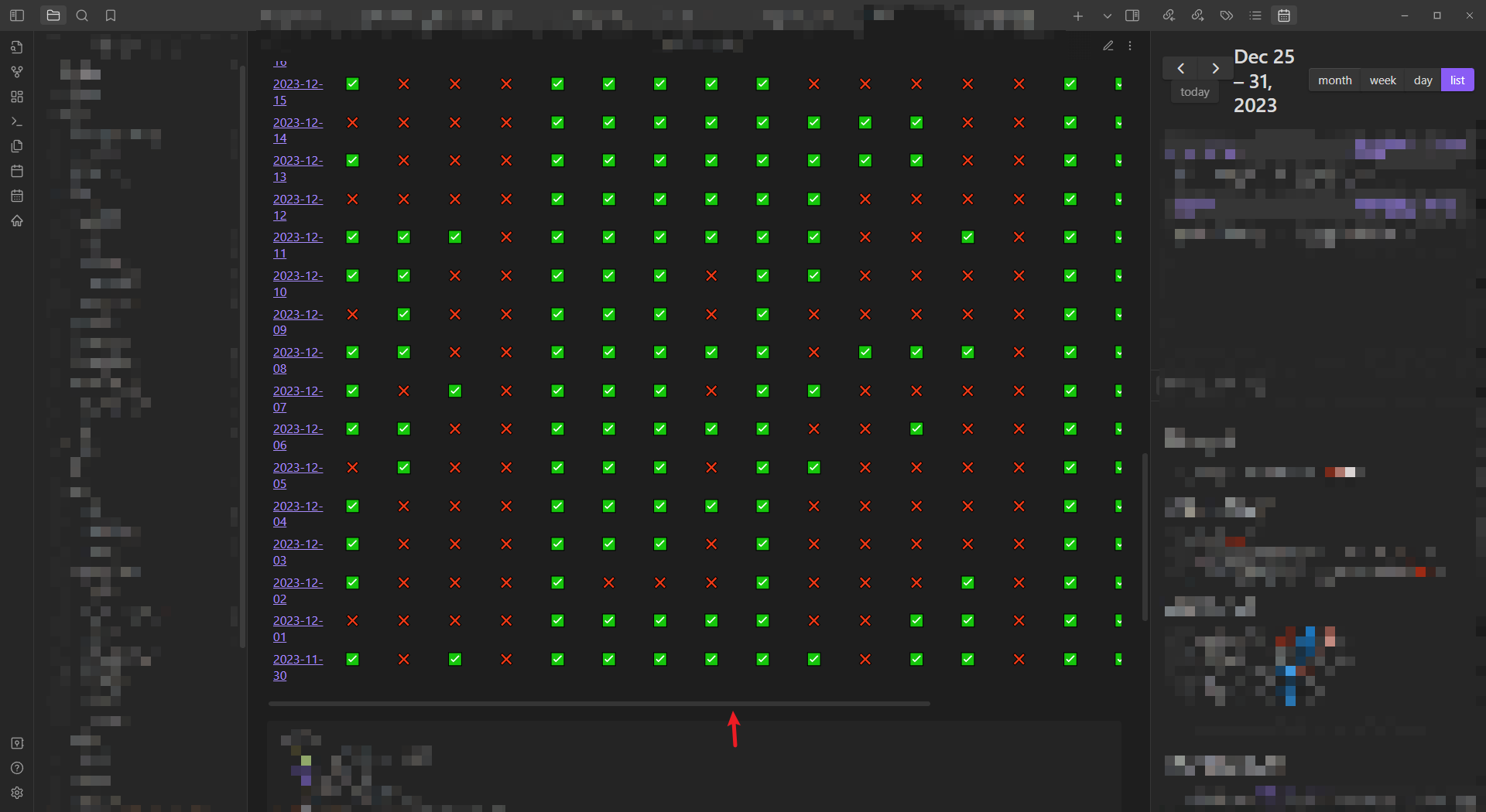

After the update it now looks like this:
The entire table has become wider and taller for each entry, forcing a scrollbar to appear (indicated by the red arrow). Due to my limited knowledge of HTML/CSS, I have been unsuccessful in my attempts to change it so that all entries appear on the page without the scrollbar, as it had before the update.

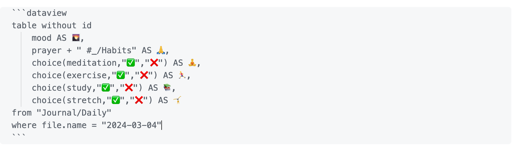

Could you explain a bit more on what you mean by adding #_/habits into the table? I am admittedly not versed in CSS at all, and don’t quite understand where I should put it. I tried putting it at the top where it says “table without ID” but it threw an error.
Here’s what my table code looks like:
Thanks a ton for the help!
As long as it is shown within the table, it doesn’t matter where you put it, so you could try doing:
file.link + " #_/habits" as Date
or
choice(Habits.....) + " #_/habits" as Icon
It really shouldn’t matter where you put it, as it’s going to become hidden anyways! :smiley:

That worked! You are a lifesaver, seriously thanks so much for the help!
I tried this but the #/Habits shows up as a tag within my table :sweat_smile:
I tried placing it in other positions in the Dataview query as well with no luck.
Any ideas what I’m doing wrong?

Sorry my mistake was not using the correct case! Works perfectly when using “#/habits" instead of "#/Habits”
Sorry @joshk , I seemed to have used the wrong casing in my example after the actual posting with the CSS, so no wonder you also used the wrong casing. Corrected my original post, so hopefully it’s not as confusing anymore.
