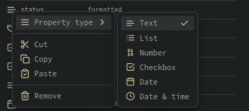

  • If you have key: value format, then Obsidian treats it as text in a single-line array (“array” in my mind means a series of more than one, but that’s the term Linter uses in its settings, in which one can define which property one wants multi-line). The icon in the Properties UI looks like this:
    Screenshot from 2024-02-16 23-25-20
    The icon seems a little similar to that of list. The important thing is that it is a ‘text string’. In my case, it is a status (either one of the two): status can be either…or, not usually and logic-wise.

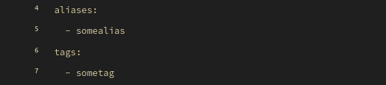

    Similarly to list items, Obsidian also has on board default properties tags and aliases which – already shown by the use of the much-debated plural (“more than one”) in the property names – will be used as multi-line properties, which is shown by the syntax used; even if there is (currently) only one tag(s) and alias(es) in the YAML, it will not be populated in key: value format (with the key and value on the same line), but in multi-line format:

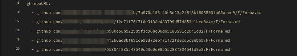

Text properties will accept multiple values and change into list properties, if you pass multiple values using processFrontmatter.
Obsidian_Zpr7TXP5yf
If you really meant a single-line array, like Linter supports, then this is not correct. Obsidian doesn’t support single line arrays. It will reformat to multi-line lists / arrays. A text property is not an array (doesn’t accept multiple values), but I think you were actually getting at that. As my test above shows, text will become list if you force multiple values onto a text property.
Using add on a property whose existing value is an array will push the new values to the existing array:
Obsidian_PnX0l4scjw
This only takes into account the existing values in the target note, not how the property is configured in the property UI. A value can only be considered an array if it’s formatted like this:
This is not nessarily the case even though the property UI says that the property type is list.
Using update on a property whose value is an array will overwrite the existing values with the new values:
Obsidian_0I6onFWtgF
