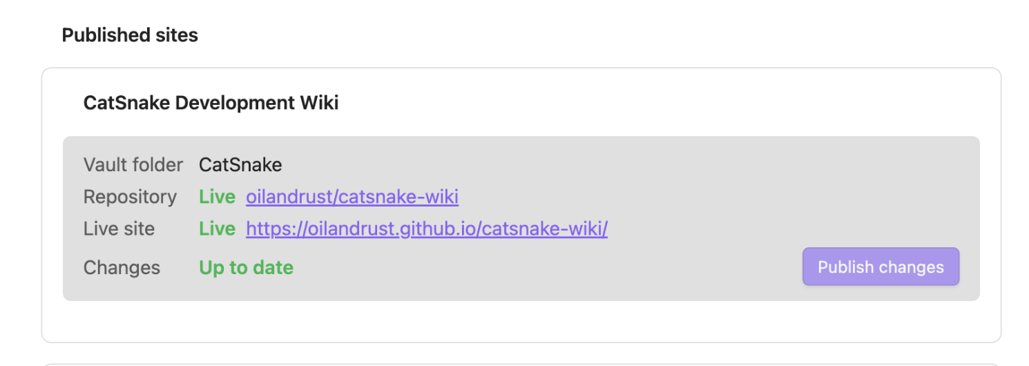

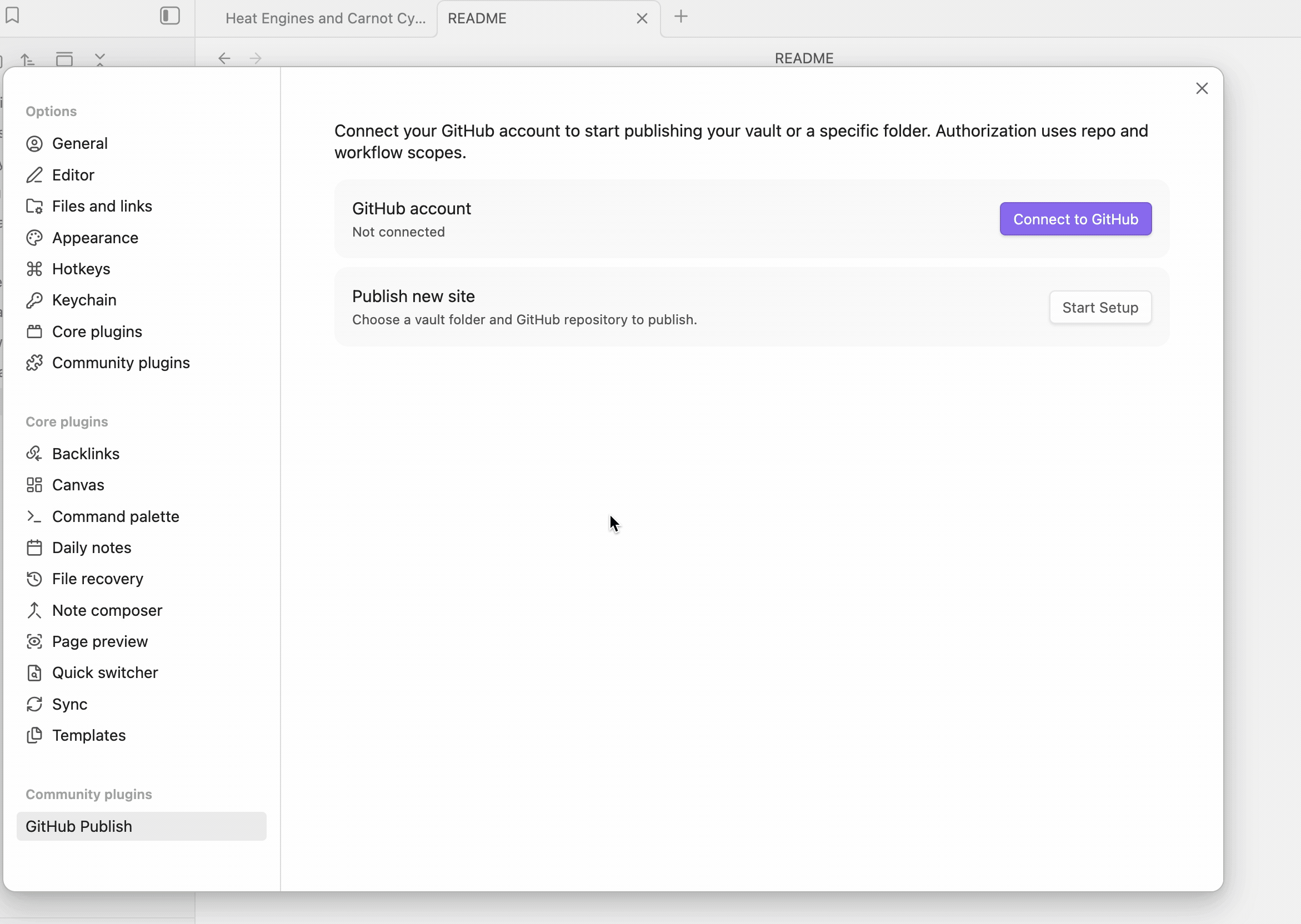

With GitHub Publish, you can publish a folder in about a minute, without touching a command line or configuration file:
setup_demo
On top of that, the plugin lets you publish multiple sites, keeps track of the status of the page, and lets you publish updates in one click.

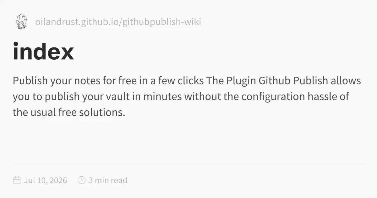

Here is the wiki for this project (real development notes) that I publish with the plugin:

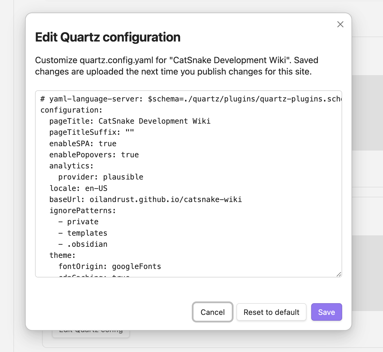

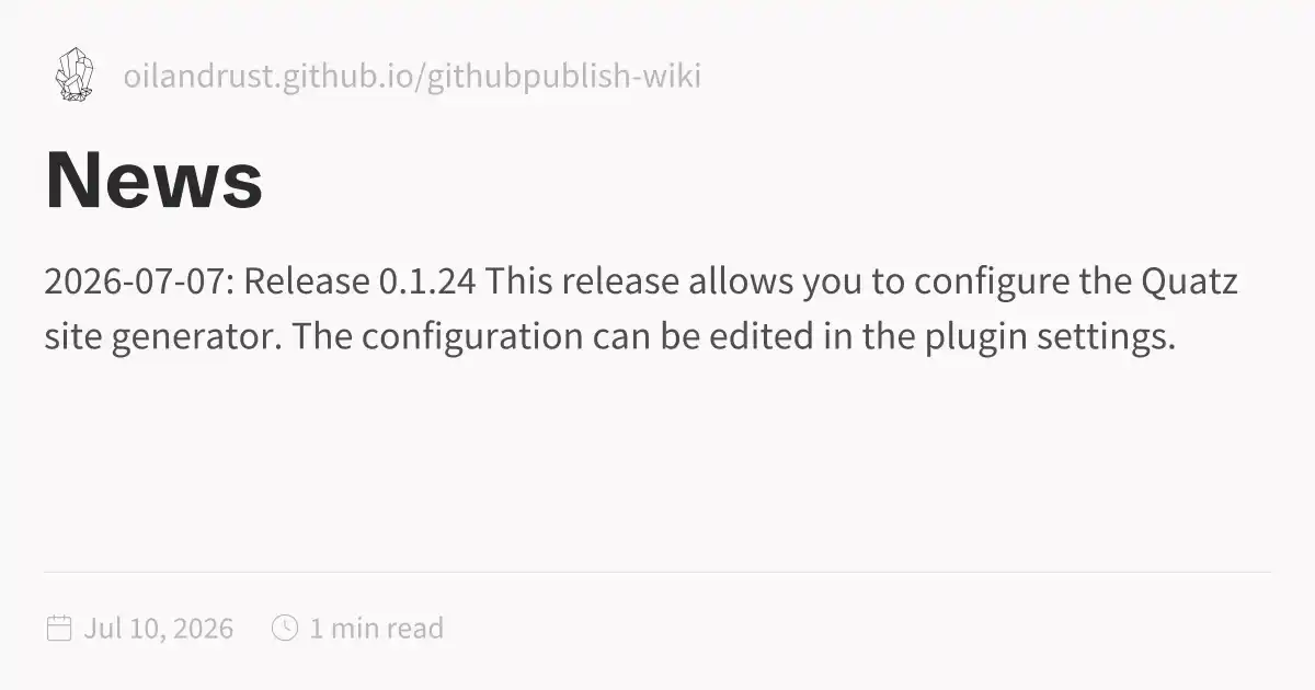

The Plugin now allows editing the Quartz config file, making the site highly configurable.
Changes to the config are detected and published the same way content is published, with a single click.
