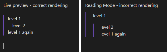

Inside a note, start a new blockquote, with a nested blockquote inside, and then finally another line on the original blockquote level, like this:
> level 1
> > level 2
> level 1 again
Switch to the reading mode, and observe how the last line (“level 1 again”) is pulled into the nested blockquote above it.
grafik
The lines “level 1” and “level 1 again” should be on the same level of indentation.
The last line of the blockquote is pulled into the nested blockquote and has an indentation of 2 instead of 1.

The rendering is fixed when there’s an empty line after the nested blockquote with the original level of indentation:
> level 1
> > level 2
> level 1 again
This probably happens because a blockquote will implicitly be continued until it’s ended by an empty new line. Setting an explicit nesting level should overrule that implicit behaviour though.

I guess then the live preview is wrong - the live preview and the reading mode should show the same thing. I’d love to adjust the original post accordingly, but Discourse won’t let me edit it anymore.
Shouldn’t the explicitly set nesting-level have precedence over the implicitly inherited level from the previous line though?
Live preview and reading mode use different markdown engines, with the latter being mostly according to standard, and the first easier to work with in an editor setting.
We would all like for there to be only one engine, but for the time being we just need to adapt to it.
