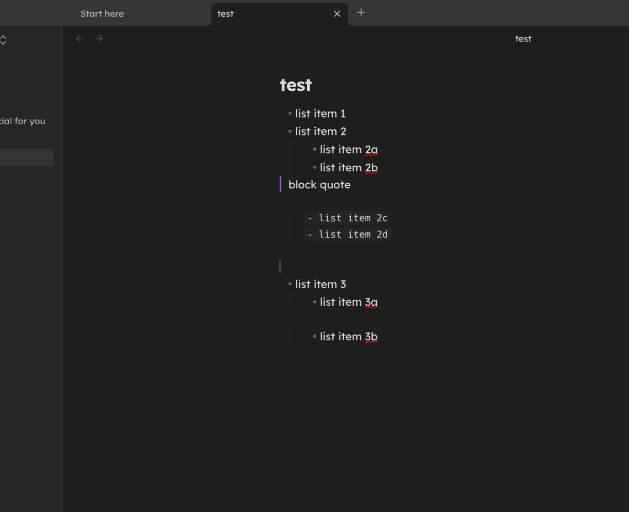

In edit view, block quotes nested within bulleted lists cause subsequent second-level bullets to render as orphans. In live view, subsequent bullets are rendered correctly.

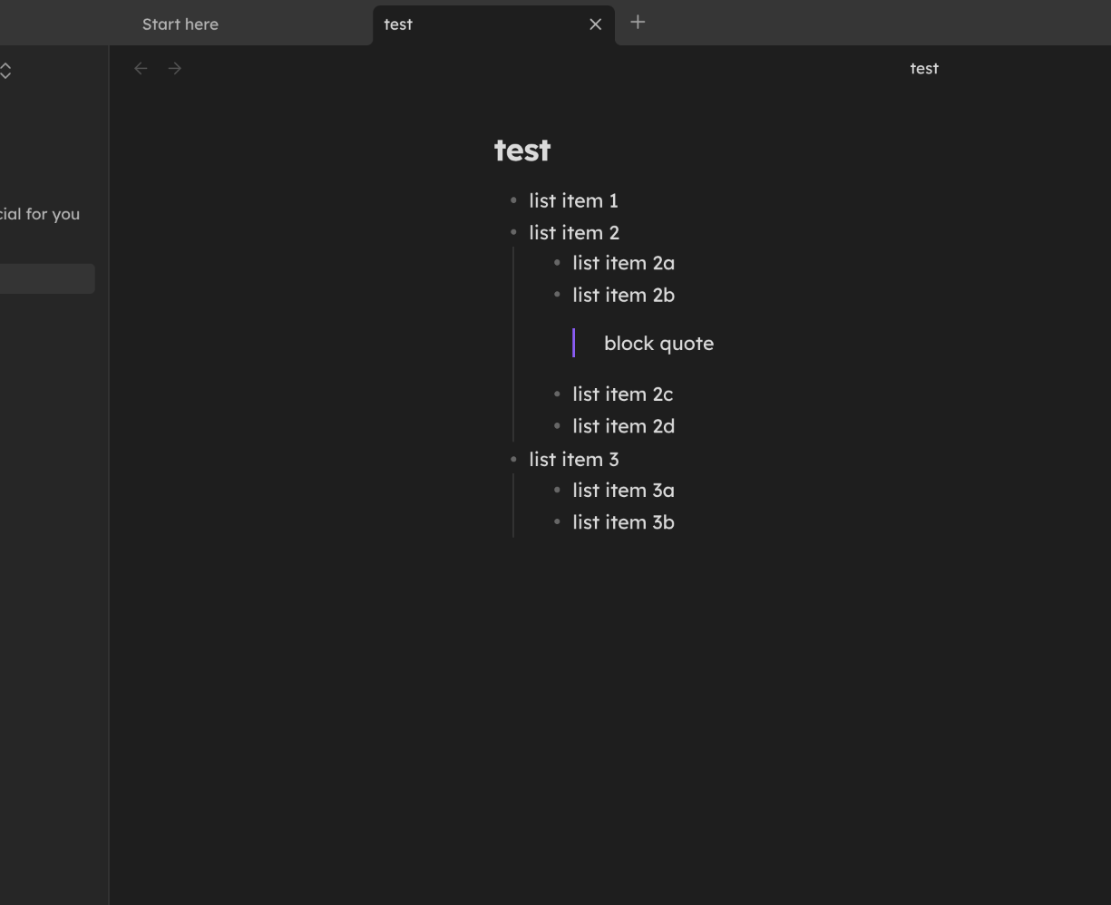

edit view follows the formatting of reader view; e.g. items 2c and 2d below are rendered properly as children of item 2
edit view renders subordinate list items as orphans; e.g. items 2c and 2d are rendered as orphan bullets

Ok, so I double checked this.
According to Commonmark, the Editor is correct and Reading mode is wrong.
