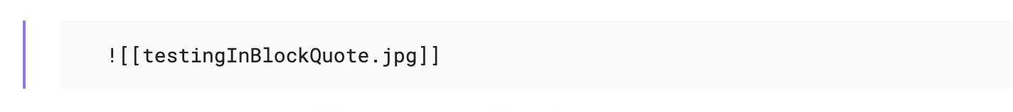

- Create a first note and embed an image inside a blockquote, like:
- Create a second note and embed the identical image as a normal markdown link

The image only gets marked for deletion if there are six or more whitespaces between > and ! in the blockquote
If you don’t have the extra whitespace, It isn’t deleted because it is linked in another file.
If you do have the whitespace, I don’t think it is a valid Markdown syntax.
By coincidence, Live Preview shows it. But if you go to Reading Mode to see how it is actually rendering, the link is pre-formatted like code.

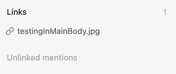

You can also verify this by looking in the Outgoing Links pain. If you have that indentation, the link doesn’t even appear.
I can’t say if this Live Preview display issue is a bug or not. (Bugs are not my department anyway. I’m just a mod.) There are always a few discrepancies between Live Preview and Reading Mode. I think this is incorrect syntax, and you’ll need to fix the indentation in your blockquote(s).
But I’d personally say there isn’t a bug in the attachment deletion itself. It’s only deleting the attachment if it is detected as not being in any other notes other than the one being deleted.
Oh I see. Thank you so much for this input. I’m still learning, sorry. Never looked at the page in reading mode. But you are completely correct. My way to indent text / images is not the correct way to do and results in an incorrect syntax. I completely relied on the live view so far, where everything looked fine. But again, you are completely right and I should look for other possibilities to indent text/images, maybe by using a snipped or something else.
