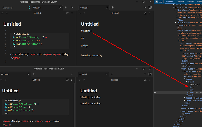

My big main vault has a dv.el("span","text") issue, I can't figure out what's wrong
Hi,
i try to found a solution for some hours.
i disable all snipets, activate the default theme, take a look in the console.
copy app.css from test to doku.utf8 without change.
in the console elements view i can see a diff between my test and doku.utf8 vault.
in the span tag after the word “Meeting:” there are two br br before the span end tag
that occurs also in the span “on” and “today”
I simplified the script a bit, normally there are variables dv.file dv.date etc. between the spans
I would be grateful for a tip on how to solve this

My complete line looks like this
dv.el("span","Meeting: ") +
dv.el("b",dv.current().file.name) +
dv.el("span"," on ") +
dv.el("i",dv.current().file.cday) +
dv.el("span"," ") +
dv.el("div",dv.date('today'), { cls: "ar" });
what is the correct $ syntax for dv.current().file.name ?
and how can i set it in bold?
