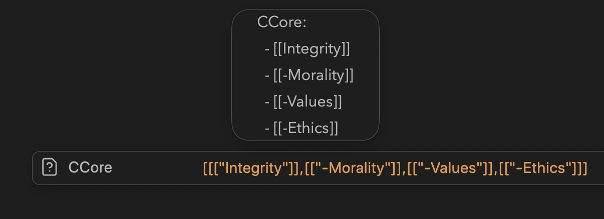

  1. In source mode
CCore:
  • [[Integrity]]
  • [[-Morality]]
  • [[-Values]]
  • [[-Ethics]]
Which also doesn’t work.

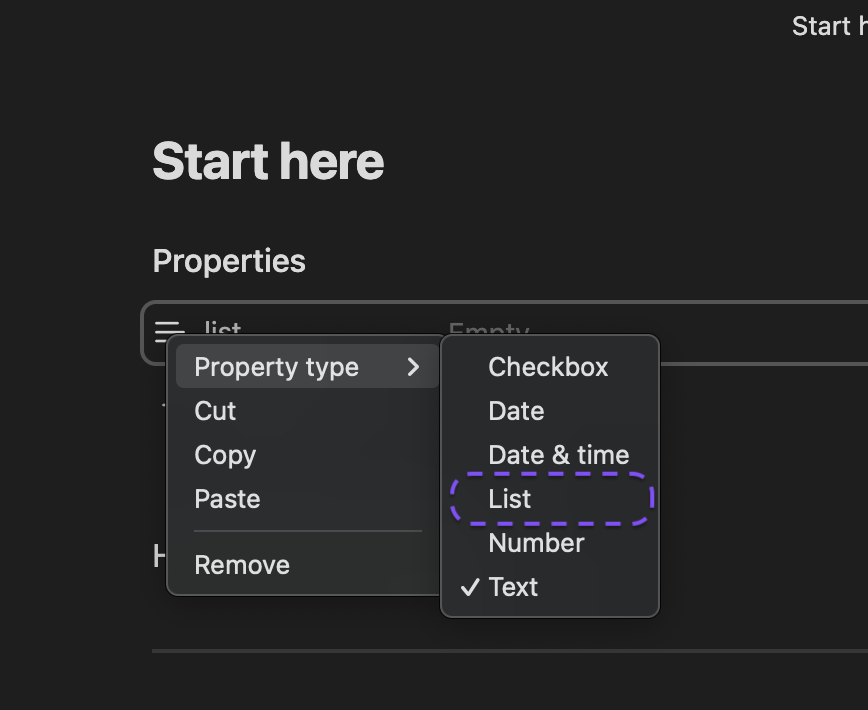

You need to change the type of key and set it to list :blush:
You can do so by clicking on the icon in front of CCore and in the dropdown titled Property type select the option List
After that, you’ll be able to store multiple links within that key :blush:

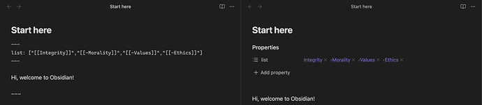

(Source Mode on the left and Live Preview on the right)

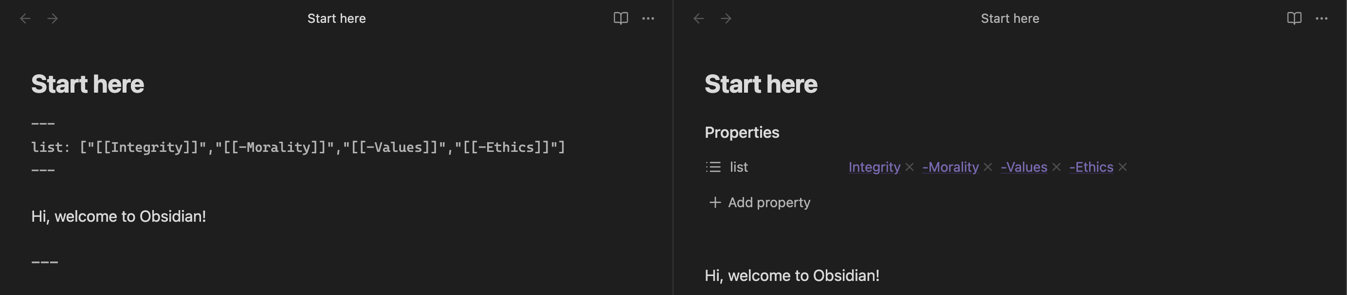

You can also write it as an array in Source mode :

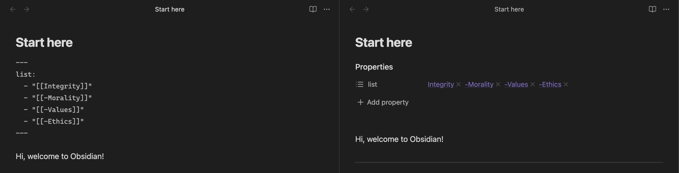

list: ["[[Integrity]]","[[-Morality]]","[[-Values]]","[[-Ethics]]"]
… but Obsidian will re-write it as a bulleted list when you or “something” will interact with Properties

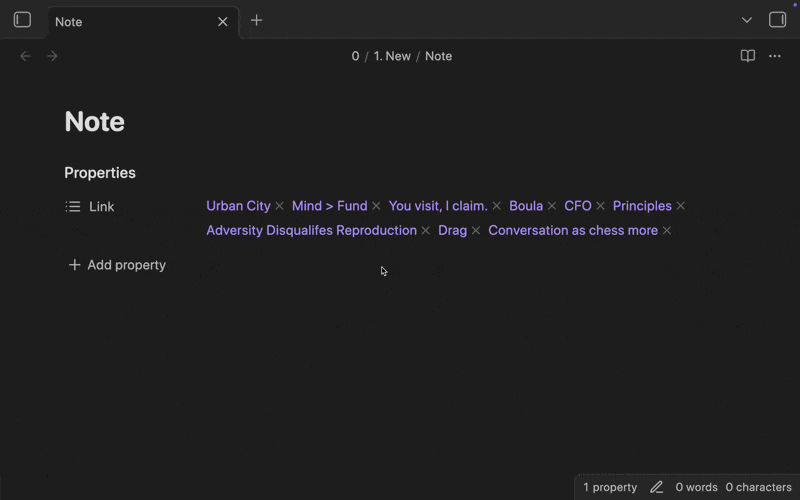

I have tested having many links in one property and it works fine. You can collapse the properties pane too so that keeps things clean. (See gif below)
A
However I doubt the practicality of it unless you have some sort of system or script to automate filling them.
And consider that in Obsidian you’re not confined to linking in properties, you can link inside the note body as well which I think would be cleaner and the right choice.
This is just my humble opinion and I might be wrong. But from a pure systems principles thinking perspective, I doubt bloating one property with links is the right design.
