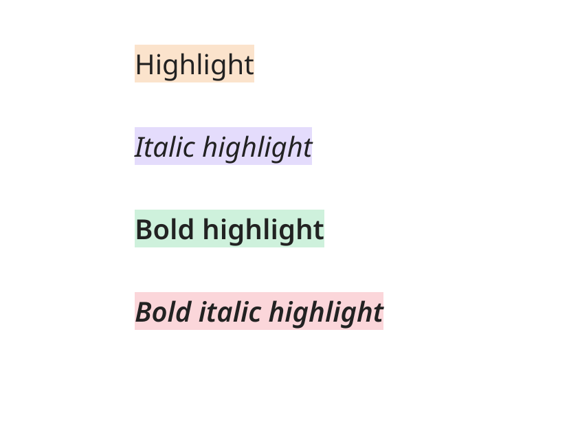

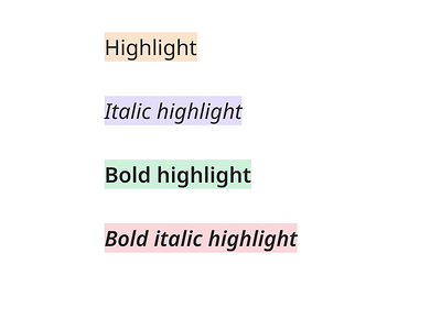

It is possible to write css to make simple highlighted text, bold highlighted text, italic highlighted text etc different colors. It gives you just a few colors, but allows to stick with markdown. Here is the code I use:
body {
  --text-highlight-bg: rgba(var(--color-orange-rgb), 0.2);
  --text-highlight-italic-bg: rgba(var(--color-purple-rgb), 0.2);
  --text-highlight-bold-bg: rgba(var(--color-green-rgb), 0.2);
  --text-highlight-bold-italic-bg: rgba(var(--color-red-rgb), 0.2);
.cm-em,
em,
mark:has(em:only-child) {
  --text-highlight-bg: var(--text-highlight-italic-bg);
.cm-strong,
strong,
mark:has(strong:only-child) {
  --text-highlight-bg: var(--text-highlight-bold-bg);
.cm-em.cm-strong, strong > em,
mark:has(strong:only-child > em:only-child) {
  --text-highlight-bg: var(--text-highlight-bold-italic-bg);
And the result:
==Highlight==
*==Italic highlight==*
**==Bold highlight==**
***==Bold italic highlight==***

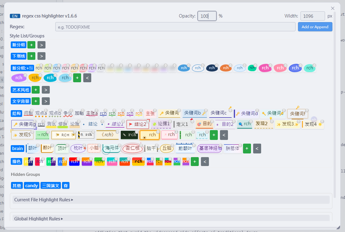

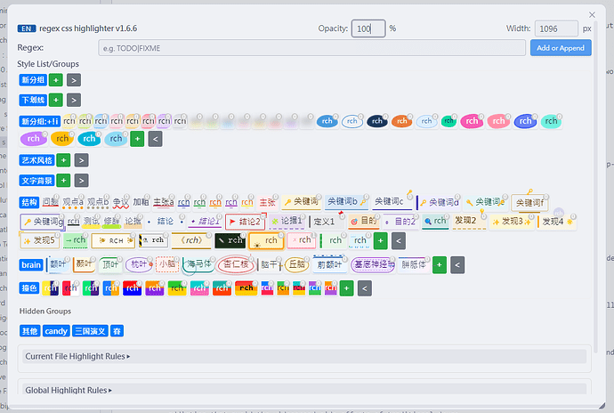

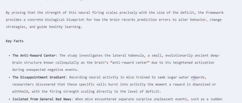

Here is another option — It lets you assign any CSS class to regex matches (or selected text), so each highlight can have its own style. I’ve been building this plugin for a while
PixPin_2026-06-07_23-26-51
